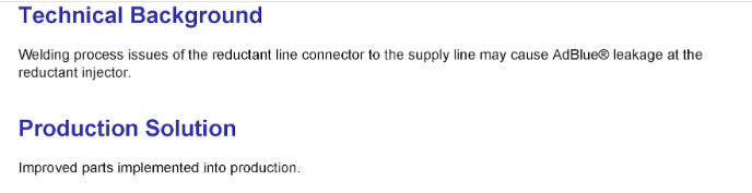

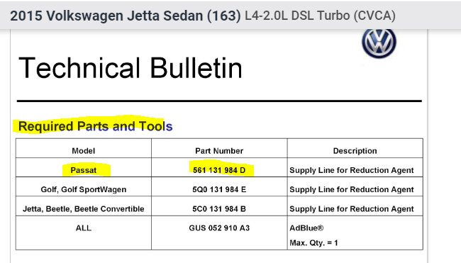

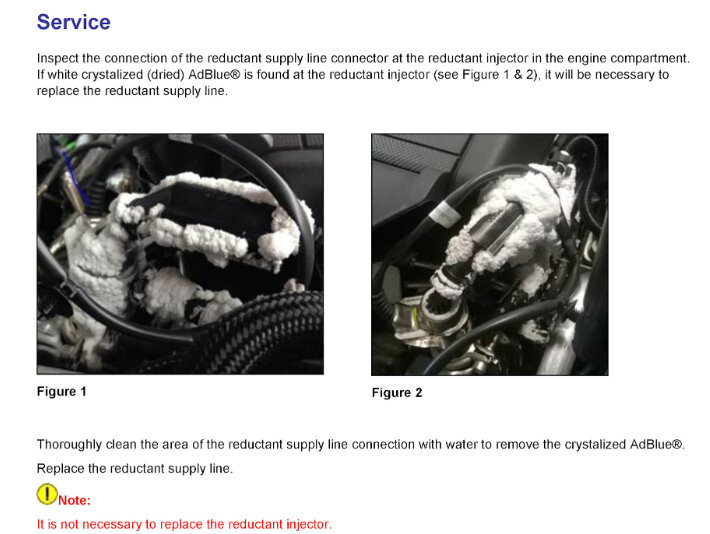

I know there is a technical service bulletin related to the light being on due to a reductant line connector issue. I read through it and there must have been some issue when the component was welded. If pressure is too low, it will prevent the operation of the system.
I attached it below so you can see it. Let me know if you can check it and determine if there is a problem.

Is there a leak? That is what would cause the low-pressure issues and prevent it from starting. If there was evidence of a leak, it is likely still present.

Maybe I can’t tell but there was crystallized around the wires.
Jan 26, 2024 at 3:28 PM
  • 110,244 POSTS
Something may be corroded. Check to make sure none of the connectors appear damaged, loose, or corroded. If everything appears okay, we need to scan the can-bus to determine what may be causing the issue. However, the idea that it was crystalized likely indicates a leak.
