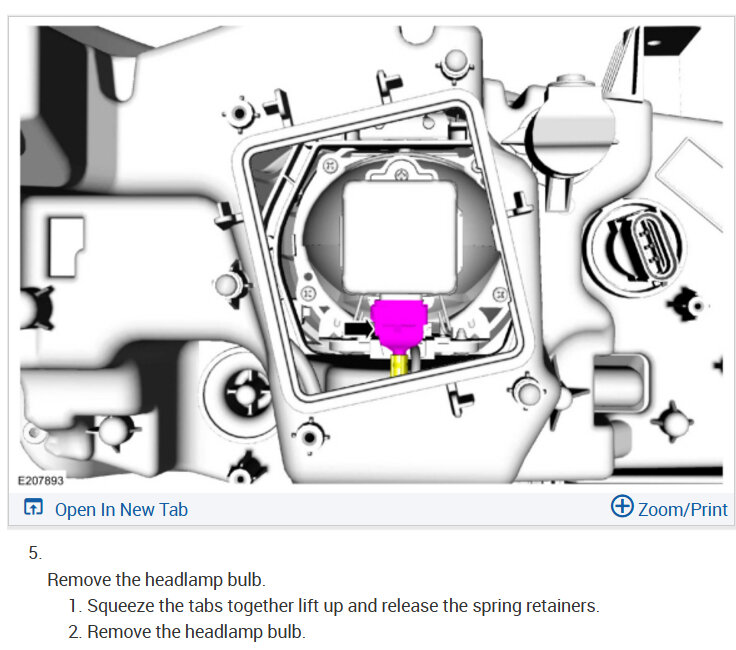

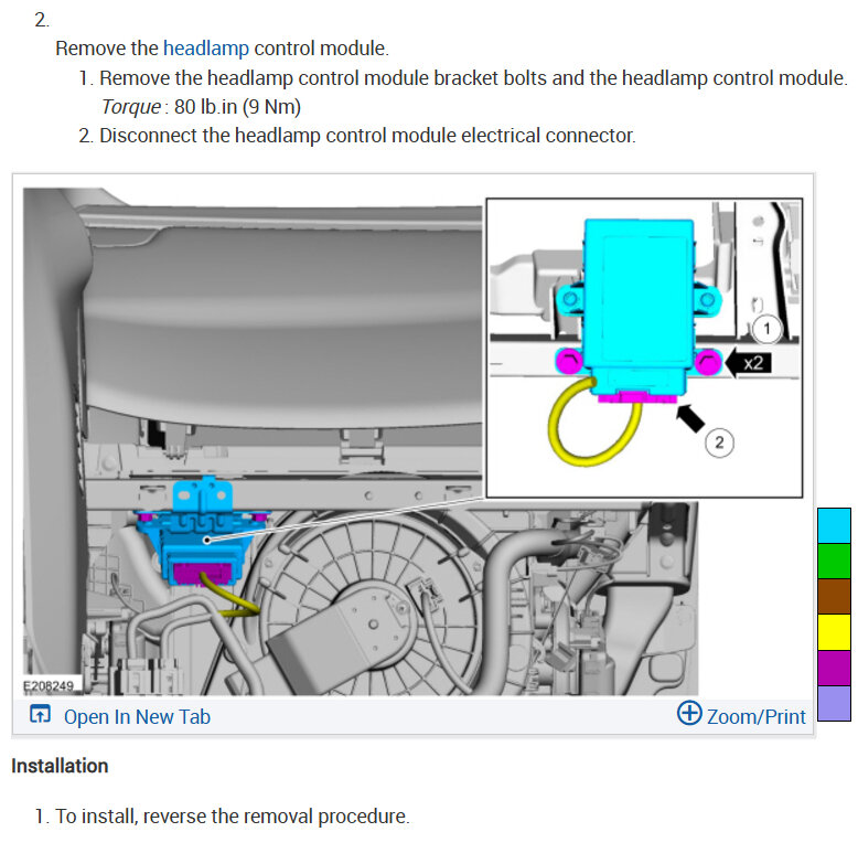

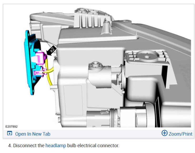

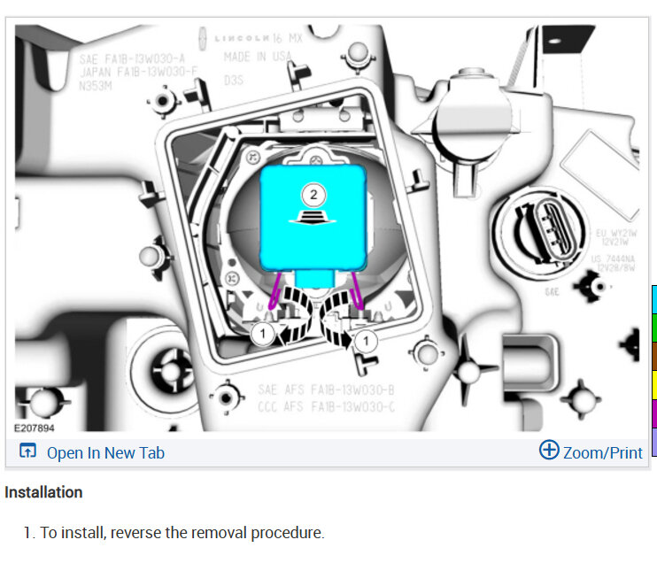

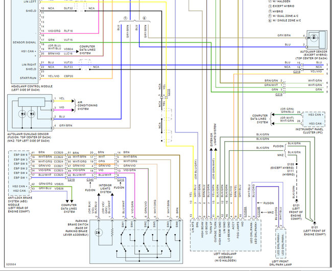

Hello my car listed above was equipped with HID adaptive headlights… I upgraded the bulbs to D3S LED bulbs unfortunately right now my RH Headlamp bulb is burnt out whereas my LH is still working… with that being said since the RH light hasn’t been working the LH light has been shining directly on to incoming traffic… when I replace the RH bulb will the LH light adjust automatically back to its correct position?
 Or will I need to replace a module for the adaptive headlights to operate correctly?
Nov 22, 2024 at 1:57 AM
  • 55,711 POSTS

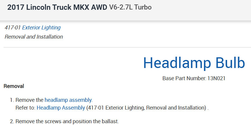

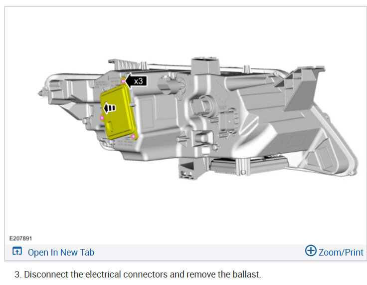

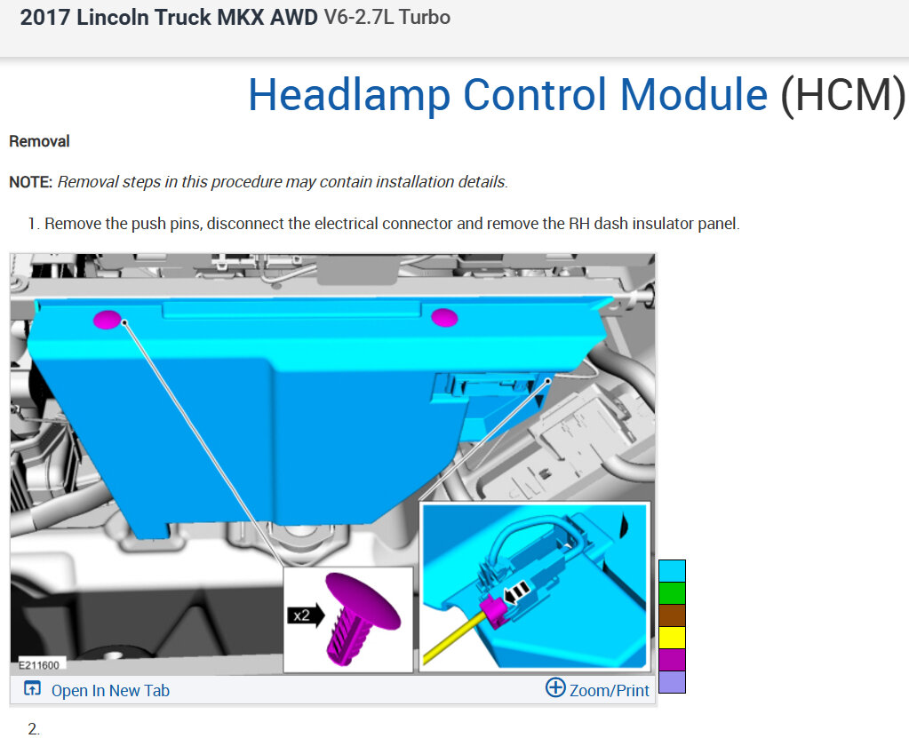

With both headlights working the system should recalibrate. These bulbs need to be installed correctly, or the system will have a hard time adjusting the light beams. Here is how to change the headlamps bulbs correctly in case you need it, also if the system is having a problem, it will leave a code which you can gather during a CAN scan. You can get a CAN scanner (Controller Area Network) which will work on most cars from Amazon.
https://youtu.be/u-4syLc-ifQ
There is no programming when these bulbs or headlight control module is replaced, FYI. Check out the images (below). Let us know how it goes.

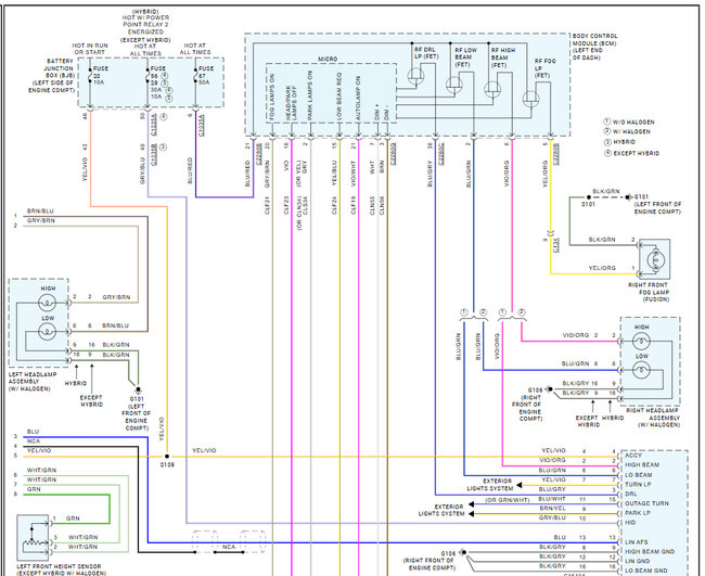

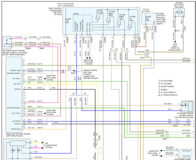

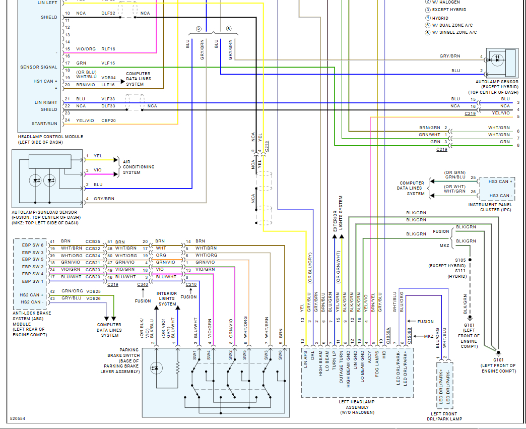

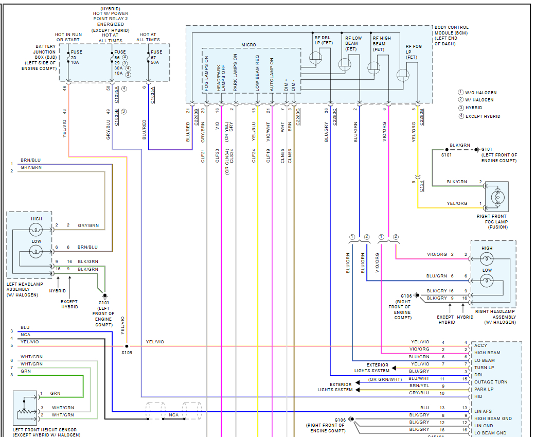

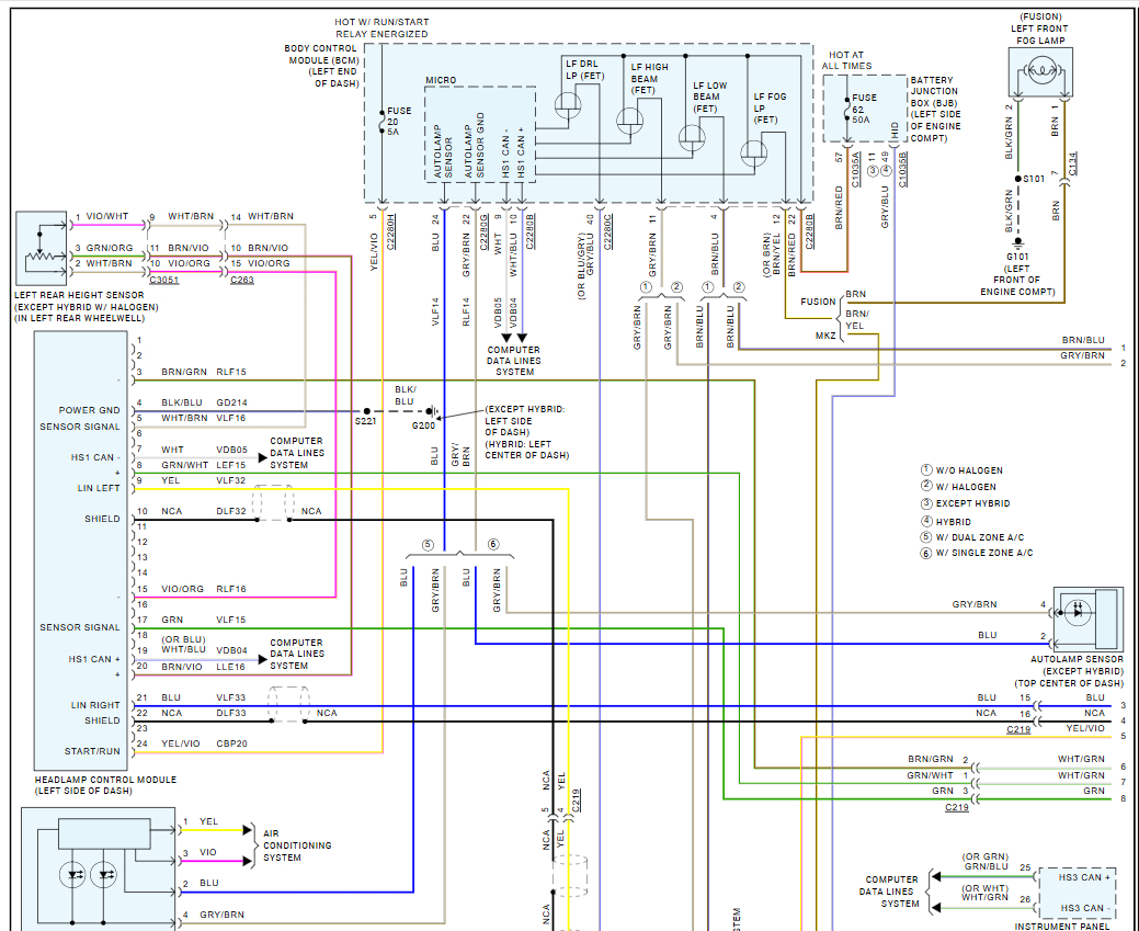

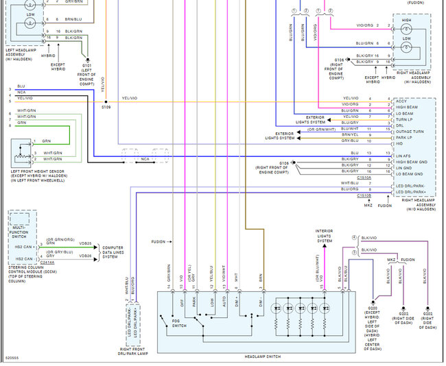

I’m trying to swap my headlights from HID to LED really could use a full harness diagram for the headlights
Dec 20, 2025 at 7:20 AM
  • 55,711 POSTS
Sure, here are the headlight wiring diagrams as requested. Check out the images (below). Let us know if you need anything else.
