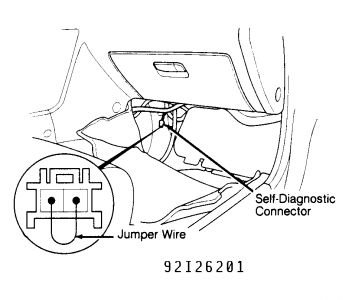

Your form didn't have the option , but this is a 5 cyl engine. *Can you tell me how I can read the codes, the engine light is on. I'm an electronic tech. I beleive the Acura Vigor requires a special code reading box compared to other pre 96 cars. Please tell me another way to retreive the codes ? Acura wants $125 to do it. Thanks

Hi Locate ECM test terminal behind glove box see diagram
https://images.2carpros.com/forum/automotive_pictures/198357_Graphic_537.jpg
Connect jumper wire across turn key on MIL will blink. One digit codes short bliks so . . . . =4 two digit codes has pause so .. ... = 23 Post codes will advise Thanks for donate
