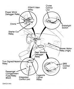

where do i find the fuel pump relay on an 93 acura vigor?

Hi joshp1981, It is the PGM-FI Main Relay in the diagram.
https://images.2carpros.com/forum/automotive_pictures/192750_Acura93VigorMainRelay_1.jpg
