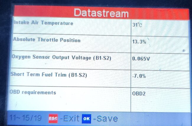

I've been dealing with a rough and low idle when stopped in Drive.
I have short term fuel trims ranging from (-10% to -15%) while in drive
So far I've adjusted the Valves lash , Installed New Spark Plugs, New Timing Chain and Tensioner, New Water Pump and New Head Gasket with Resurfacing of cylinder head before installing.
Are there any diagnostic instructions for this issue you can provide me with? I'm considering replacing the ECT Sensor or MAP sensor.

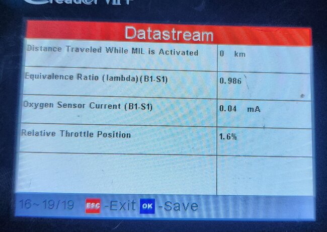

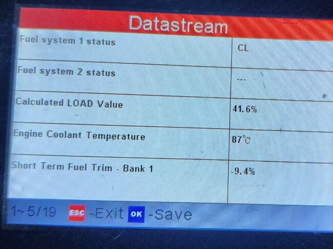

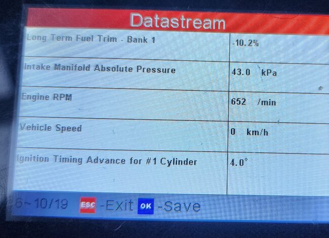

I've added 4 pictures of current values on my OBD2 scanner in case any irregularities are found on your end, thank you.

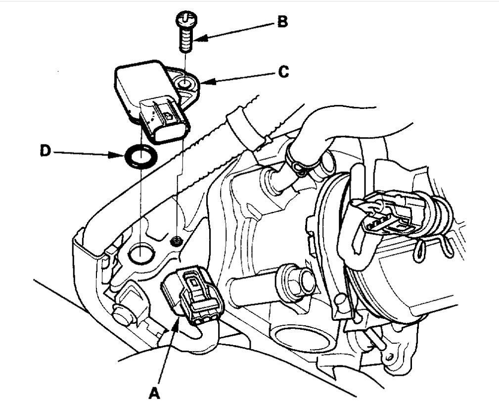

When you replaced the spark plugs were they black? Because these numbers are for a rich mixture, The MAP sensor reading can be off which will cause this.
Here is the location of the MAP sensor so you can swap it out to see if the readings change.
Also check the O ring seal for the sensor as well.

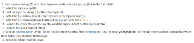

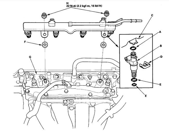

Is there any way to test the injectors for leakage ?
Jul 30, 2024 at 4:14 AM
  • 55,797 POSTS
Yep, here is a guide to help with that, but since they all looked the same I don't think they are a problem but you never know.

I replaced the map sensor and the fuel trim values went to 0% momentarily before going negative again.

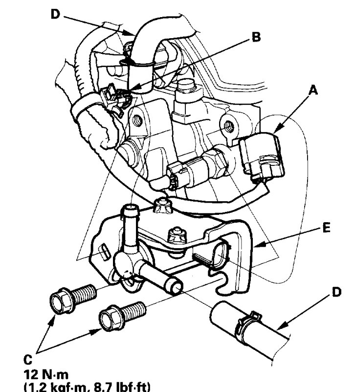

Could the evap purge valve also be a suspect?
If my timing were a tooth or half a tooth off would that also cause a rich condition?

Yes, the valve can cause a rich condition here is the location so you can check it out, remove it and see if you can blow through it, if so, the valve is bad. Yes, if the timing of your engine is a tooth or half a tooth off, it can indeed cause a rich condition. Check out the images (below). Let us know how it goes.

I plugged the vacuum line that comes from intake to the evap purge valve, and the car was running lean for the first time in a while but after a while my long-term trims reached negative again
