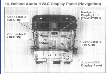

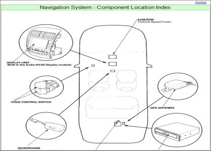

I have a 2004 Acura TSX with navigation and the other night when I started the car I noticed that the clock did not light up and the lights around the nav pod/radio did not illuminate. when you shine a flash light at the pod holding the clock, the clock and radio displays are working normally, just not lit up. I checked all the fuses on the drivers kick panel and under the hood and all are okay. is this one light illuminating all the positions or multiple lights and I am missing something somewhere?

Hello - I am not sure how many fuses you checked - so I want to make sure you and I are on the same page. These are the fuses I show that tie into that system....that the clock and Nav system are on together. The under-hood Fuse Relay box, Fuses 15, 22, 23 and the under-dash box, fuses 8 and 32. When you checked the fuses, did you use an ohm meter??? Sometimes a visual with the eye just isn't good enough as it can not be working in a spot you can see. I have searched two tech manuals for bulbs.....if the fuses are good you many have to call the part department and ask how many bulbs are on it. I have attached two pics for you....the one actually shows the back...but in the pic I can not see a bulb. Maybe it's just hard to see.
