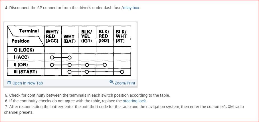

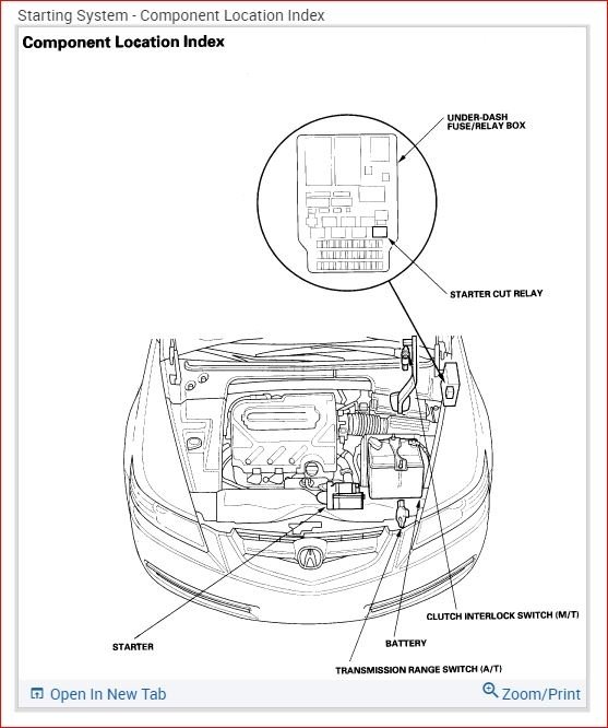

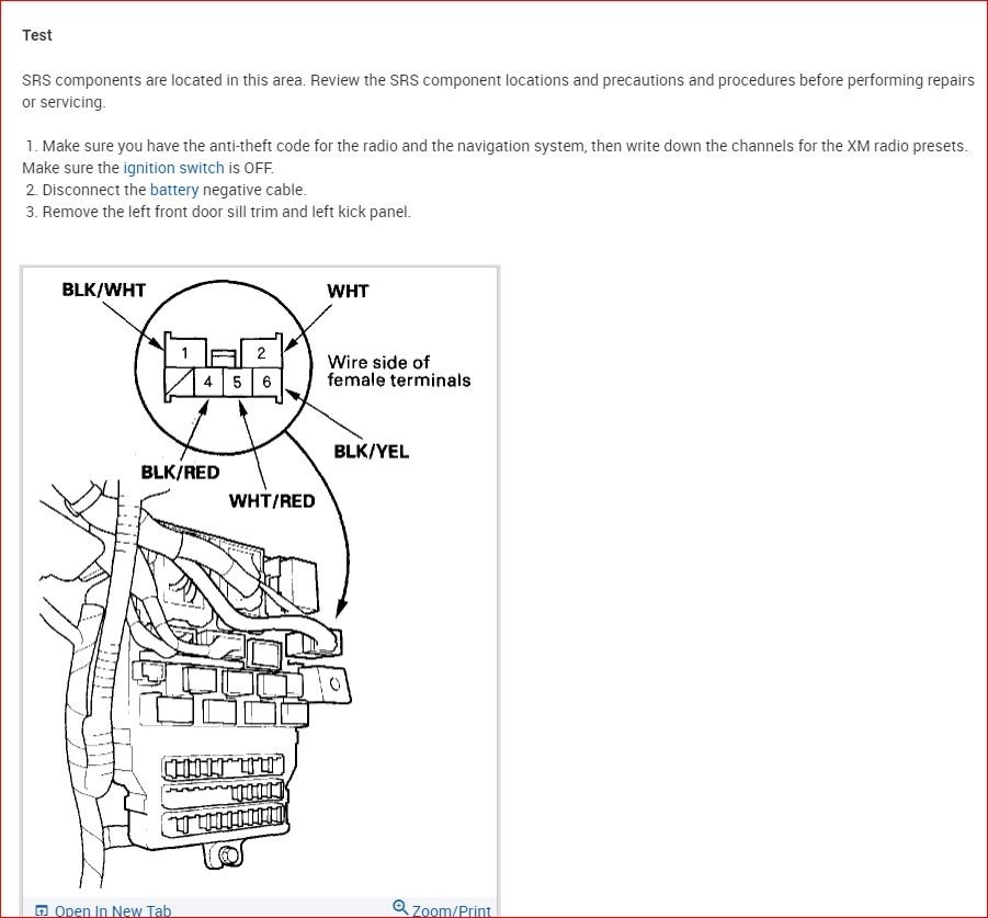

This sounds like a couple of things. It could be a relay, starter, ignition switch, or a weak battery. Unfortunately, there isn't one thing I can tell you to replace. You will need to do a little testing first.
Easiest thing to start with is to hook up jumper cables to another vehicle and see if it starts. If it does then it is the battery.
If not, you will need to do some electrical testing.
I attached a couple of guides that explain the starter side and a video that walks through what I am thinking your issue is. This is a common problem on Accords and your car is not much different.
