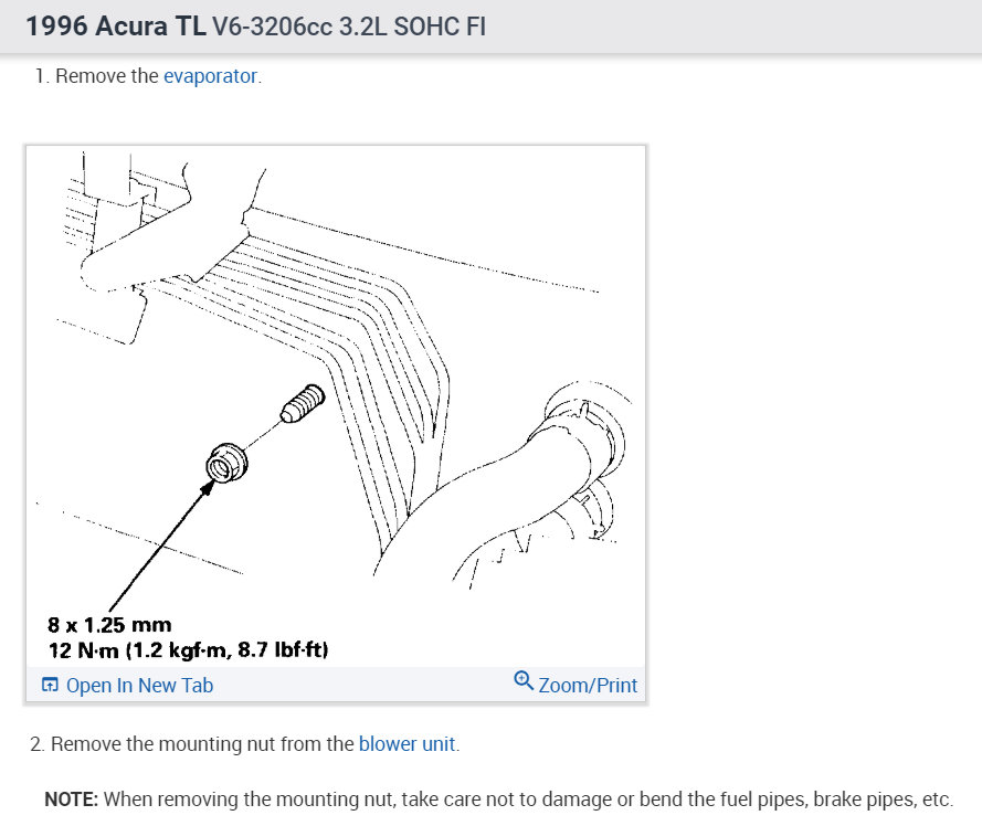

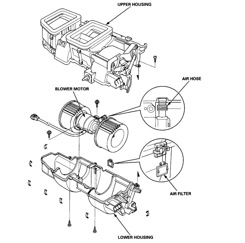

I was trying to replace my blower motor in my 96 acura 2.5 tl. I have a chilton manual for my car and it doesn't say anything about having to remove the dashboard. I cannot see the motor so i don't understand where it is and what i have to do to remove it. I really need help, thank you.

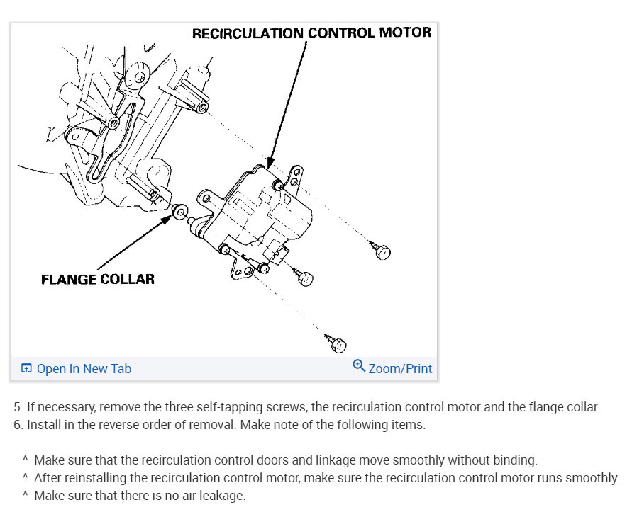

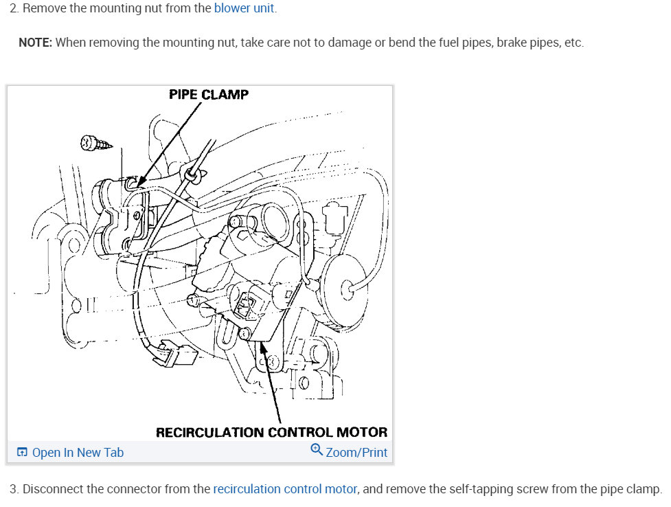

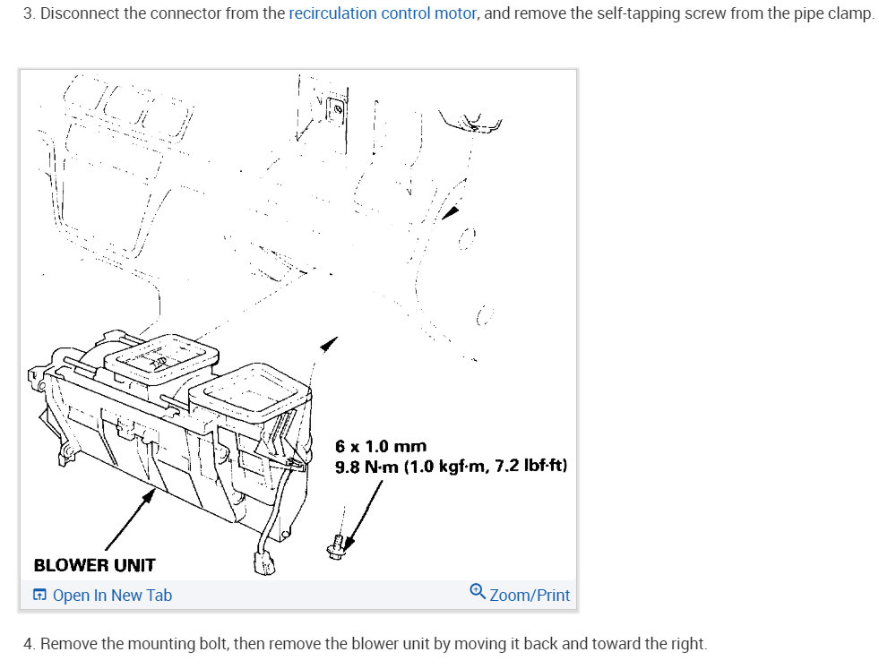

It looks like the dash will need to be removed and the air conditioner vacuumed down here is a guide to help you get started and the diagrams below show the work that needs to be done to replace the blower motor.
Crazy design BTW :(
