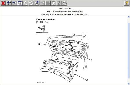

I purchased a cabin filter and the instructions are not correct. what are the steps to replace the cabin air filter?
Dec 10, 2008 at 9:42 PM
KHLOW2008
  • CAR REPAIR CONTRIBUTOR
  • 41,814 POSTS
Hi there, Removal & Installation 1. Remove the glove box housing. Release the clips by gently pulling the bottom of the glove box housing (A) out, and disconnect the trunk lid opener main switch connector (B) and light bulb connector (C).

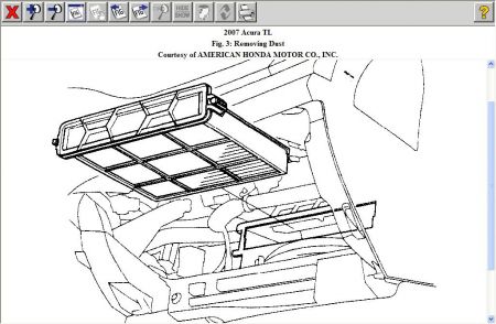

Replace the four clips along the top edge of the glove box housing. 2. Remove the dust and pollen filter assembly from the evaporator.
https://images.2carpros.com/forum/automotive_pictures/192750_CabinFilter08TL03_1.jpg

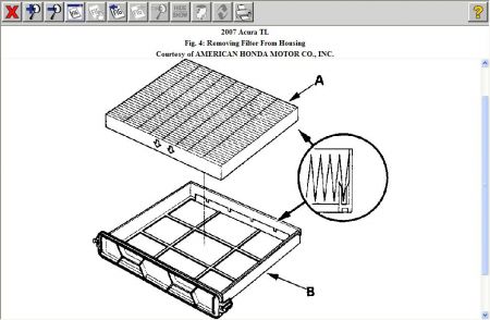

3. Remove the filter (A) from the housing (B), and replace the filter.
https://images.2carpros.com/forum/automotive_pictures/192750_CabinFilter08TL04_1.jpg
4. Install the filter in the reverse order of removal. Make sure that there is no air leaking out of the evaporator.
