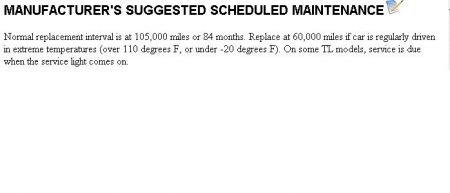

Does this car have a timing belt or timing chain? And when should I replace it. I think that a timing chain never needs replacement. Is this true?

You have timing belt. Timing chain never needs replacement? Not true. It does need replacement, and its idler and tensioner as well.
https://images.2carpros.com/forum/automotive_pictures/55316_tltbelt_1.jpg
