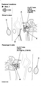

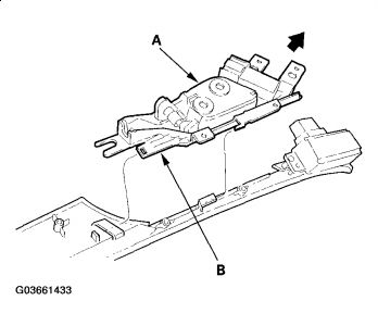

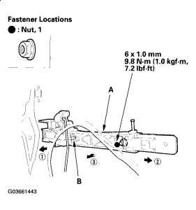

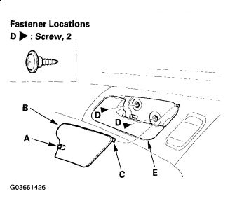

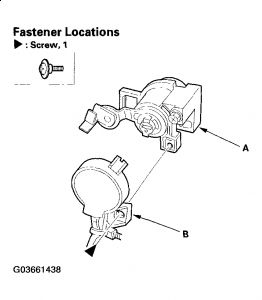

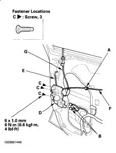

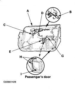

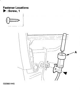

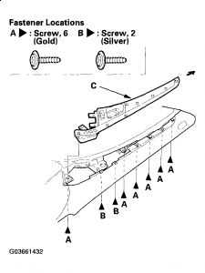

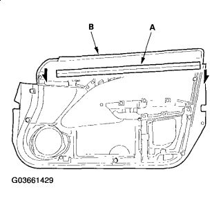

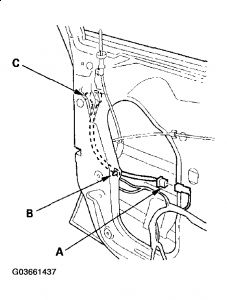

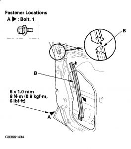

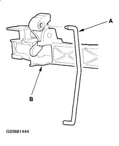

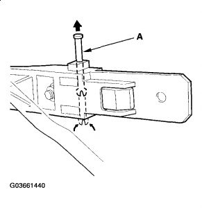

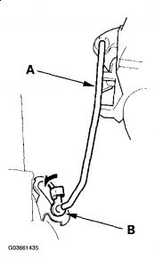

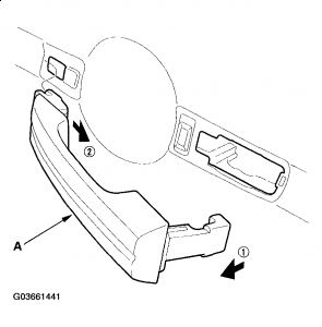

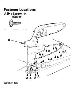

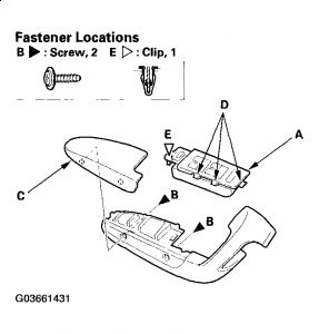

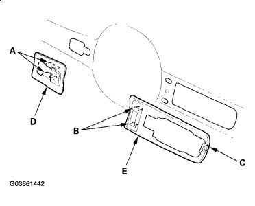

The small plastic part of the door handle is gone
I purchased new ones but how do I replace them
The metal part is still on the door does it need to come off Help
Mar 31, 2009 at 5:52 PM
JAMES W.
  • 2,394 POSTS
You will need to remove the inner door panels to access the retainer for the door handle. You replace or repair as an assembly.

Hello - I gave you a little more in case you needed it. FRONT DOOR PANEL REMOVAL/INSTALLATION Special Tools Required "¢ KTC trim tool set SOJATP2014* "¢ Trim pad remover, Snap-on A 177A or equivalent, commercially available *Available through the American Honda Tool and Equipment Program; call 888-424-6857 NOTE: Use the appropriate tool from the KTC trim tool set to avoid damage when prying components. 1. Lower the glass fully. 2. Using a trim tool, push on the rear hook (A) and pivot the cover (B) on the front hook (C), then remove the cover and the screws (D) securing the inner handle (E). Fig. 6: Pushing On Rear Hook And Pivot Cover On Front Hook Using Trim Tool

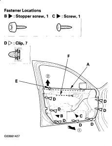

3. Remove the door panel (A) with as little bending as possible to avoid creasing or breaking it. o -1 Remove the stopper (B) and screw (C) from the door panel. o -2 Release the clips (D) that hold the door panel with a commercially available trim pad remover. o -3 Starting at the rear, pull the door panel upward, then release the lock knob (E). NOTE: The inner handle cable (F) is connected to the door panel. Do not pull the door panel up too far, or the inner handle cable will be damaged. 4. Fig. 7: Removing Door Panel

5. While holding the door panel (A) away from the door, disconnect the inner handle cable (B), driving position memory switch connector (C) (driver's door), power door lock switch connector (D), power window switch connector (E, F), harness connector (G) (driver's door), door courtesy light harness clips (H) (passenger's door), and remove the door courtesy light (I) (passenger's door) by turning it counterclockwise one quarter turn. Fig. 8: Disconnecting Inner Handle Cable

6. If necessary, remove the door glass inner weatherstrip (A) from the door panel (B) by pulling it down. Fig. 9: Removing Door Glass Inner Weatherstrip From Door Panel

7. Remove the screws (A), then remove the door grip (B). Fig. 10: Removing Door Grip
https://images.2carpros.com/forum/automotive_pictures/248015_F10_2.jpg
8. Remove the power window switch panel (A). o - Remove the screws (B), then remove the armrest (C). o - Release the hooks (D) and clip (E), then remove the power window switch panel. Fig. 11: Removing Power Window Switch Panel Courtesy of AMERICAN HONDA MOTOR CO., INC.
https://images.2carpros.com/forum/automotive_pictures/248015_F11_2.jpg

10. Remove the inner handle (A) by releasing the hook (B). Fig. 13: Removing Inner Handle
https://images.2carpros.com/forum/automotive_pictures/248015_F13_2.jpg
11. Install the door panel in the reverse order of removal, and note these items: "¢ Check for damaged or stress-whitened clips, and replace them with new ones. "¢ Make sure the connectors are plugged in properly, and the cable is connected properly. "¢ Make sure the window and power door lock operate properly. "¢ Reset the power window control unit (see RESETTING THE POWER WINDOW CONTROL UNIT ) on the door that the panel was removed from. FRONT DOOR OUTER HANDLE REPLACEMENT NOTE: Put on gloves to protect your hands. 1. Remove these items: "¢ Door panel (see FRONT DOOR PANEL REMOVAL/INSTALLATION) "¢ Plastic cover, as necessary (see COMPONENT LOCATION INDEX - FRONT DOOR) 2. Raise the glass fully. 3. Remove the bolt (A), then remove the center lower channel (B) by pulling it downward. NOTE: Be careful of sharp edges. 4. Fig. 14: Removing Center Lower Channel Pulling Downward
https://images.2carpros.com/forum/automotive_pictures/248015_F14_2.jpg
5. Disconnect the outer handle rod (A) from the bushing (B). NOTE: Check the bushing for damage and replace if necessary. 6. Fig. 15: Disconnecting Outer Handle Rod From Bushing
https://images.2carpros.com/forum/automotive_pictures/248015_F15_1.jpg
7. Remove the lock cylinder (A) (driver's door) or outer handle cover (B) (passenger's side). "¢ - Remove the maintenance hole seal (C). "¢ - Loosen the bolt securing the lock cylinder (driver's door), or outer handle cover (passenger's side). "¢ - Disconnect the cylinder rod (D) (driver's door) from the bushing (E). NOTE: "¢ Hold the lock cylinder (driver's door) or outer handle cover (passenger's side) with your hand to prevent it from falling when removing the bolt. "¢ Check the bushing for damage and replace if necessary. Fig. 16: Removing Lock Cylinder (Driver's Door) Or Outer Handle Cover (Passenger's Side)

9. Remove the screw, then separate the lock cylinder (A), cylinder switch (B) (driver's door). NOTE: Keep your hand over the outer handle cover to prevent it from falling during removal. 10. Fig. 18: Separating Lock Cylinder

12. Pull the pin (A) up while pinching its lower end. Fig. 20: Pulling Pin Pinching Lower End
https://images.2carpros.com/forum/automotive_pictures/248015_F20_1.jpg

15. Remove the outer handle base (A). "¢ - Loosen the nut. "¢ - Release the tab (B) and slide the outer handle base forward. Fig. 23: Removing Outer Handle Base
https://images.2carpros.com/forum/automotive_pictures/248015_F23_2.jpg
16. Disconnect the outer handle rod (A) from outer handle base (B). Fig. 24: Disconnecting Outer Handle Rod From Outer Handle Base
https://images.2carpros.com/forum/automotive_pictures/248015_F24_2.jpg
17. Install the handle in the reverse order of removal, and note these items: "¢ Reinstall the lock cylinder (driver's door) or the outer handle holder (passenger's door) before installing the outer handle cover. "¢ Make sure the cylinder switch harness is routed properly (driver's door). "¢ Make sure the cylinder switch connector is plugged in properly, and each rod is connected securely (driver's door). "¢ Make sure the door key cylinder/door locks operate properly (driver's door). "¢ Make sure the door handle works properly. "¢ When reinstalling the door panel, make sure the plastic cover is installed properly and sealed around its outside perimeter to prevent water leaks. FRONT DOOR LATCH REPLACEMENT NOTE: Put on gloves to protect your hands. 1. Raise the glass fully. 2. Remove these items: "¢ Door panel (see FRONT DOOR PANEL REMOVAL/INSTALLATION) "¢ Plastic cover, as necessary (see COMPONENT LOCATION INDEX - FRONT DOOR) "¢ Center lower channel (see step 3. ) 3. Disconnect the cylinder rod from the lock cylinder, and disconnect the outer handle rod from the outer handle (see step 5 ). 4. Remove the screw securing the lock knob (A). Fig. 25: Removing Screw Securing Lock Knob
https://images.2carpros.com/forum/automotive_pictures/248015_F25_1.jpg
5. Detach the inner handle cable clip (A), and disconnect the actuator connectors (B). Remove the screws (C), then remove the latch (D) through the hole in the door. Take care not to bend the cylinder rod (E), inner handle cable (F), and lock cable (G). Fig. 26: Detaching Inner Handle Cable Clip

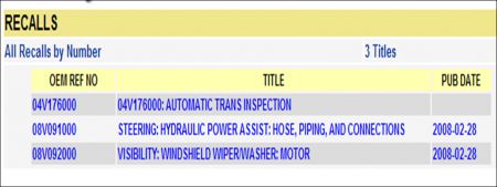

Hello - Also, it looks like you may have some recalls on your vehicle. The dealer may fix these for free. Please contact the dealer service department, give them the VIN number of your car and have them check on these to see if they apply to you.
https://images.2carpros.com/forum/automotive_pictures/248015_Recalls_30.jpg
