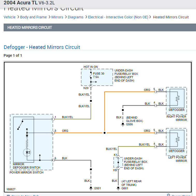

My dashboard, steering wheel and console indicator lights have been vanishing one-by-one in the 6 plus years I have owned the car. The steering and center console lights were replaced, but they neglected to check out the dashboard, and I notice the MAX and the INFO bulbs need replacement as well. My question is:
Does the Mirror Heater switch have illumination? (other than the indication that it is on, that is)

On this vehicle the mirror heater switch does not have illumination, only the indicator when it's on.
As for the light not working over time, some of these vehicles have that issue depending on the climate they are in. It is more common with the cars in high humidity climate for the dash lights to go out compare to non humid climate.
