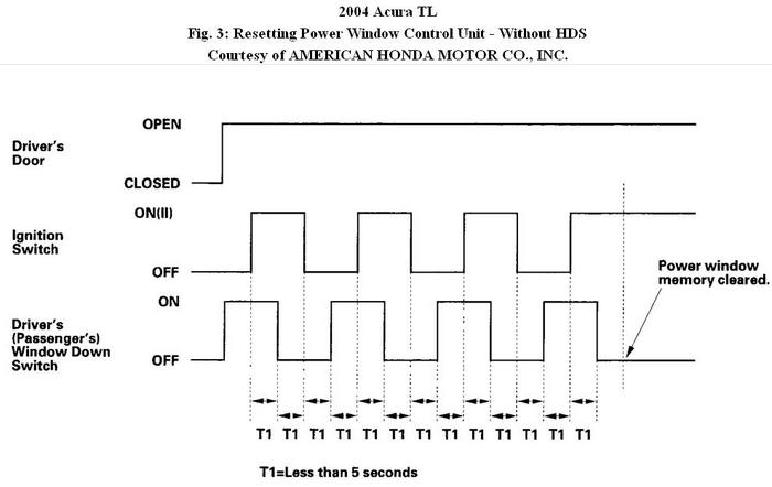

Resetting Power Window Control Unit
1. Turn the ignition switch ON (II).
2. Move the driver's window all the way down by using the driver's
window DOWN switch. ( DO NOT use Auto Mode)
3. Open the driver's door.
NOTE:
Steps 4-7 must be done within 5 seconds of each other. Refer to Fig. 3:
4. Turn the ignition switch OFF.
5. Push and hold the driver's window DOWN switch.
6. Turn the ignition switch ON (II).
7. Release the driver's window DOWN switch.
8. Repeat step 4-7 three more times.
9. Wait 1 second.
10. Confirm that AUTO UP and AUTO DOWN do not work. If AUTO UP and DOWN work, go back to step 1.
11. Move the driver's window all the way down by using the driver's window DOWN switch.
12. Pull up and hold the driver's window UP switch until the window reaches the fully closed position, then continue to hold the switch for 1 second.
13. Confirm that the power window control unit is reset by using the driver's window AUTO UP and AUTO DOWN function.
If the window still does not work in AUTO, repeat the procedure several times, paying close attention to the 5 second time limit between steps.
© 2008 Mitchell Repair Information Co., LLC.
If you can spread the lubricants onto the runchannel, that would be the best. Firt try some lubricants on the runchannel and using the glass to do the work.

OK, thank you. The instructions for the motor reset specify the driver's window. Is it exactly the same for the passanger window...only using the passenger window button? Does it matter whether I use the driver's side passenger button or the actual passanger side button?
Nov 30, 2010 at 10:01 AM
KHLOW2008
  • 41,814 POSTS
Yes, for passenger window same procedures and either side switch can be used.
