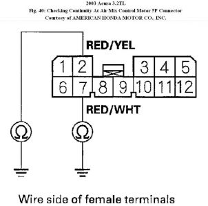

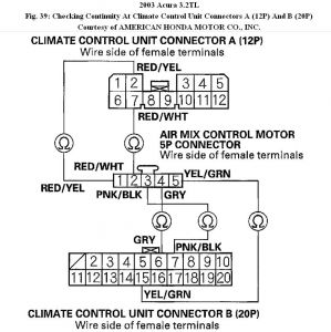

Here are the description and diagnostic procedures. DTC INDICATOR LIGHT I: AN OPEN IN THE AIR MIX CONTROL MOTOR CIRCUIT 1. Disconnect the air mix control motor 5P connector. 2. Disconnect climate control unit connectors A (12P) and B (20P). 3. Check for continuity between following terminals of climate control unit connectors A (12P) and B (20P) and the air mix control motor 5P connector.
https://images.2carpros.com/forum/automotive_pictures/192750_HVACDTC03TLFig39_1.jpg
https://images.2carpros.com/forum/automotive_pictures/192750_HVACDTC03TLFig40_1.jpg
Is there continuity? YES -Check for loose wires or poor connections at climate control unit connectors A (12P) and B (20P) and at the air mix control motor 5P connector. If the connections are good, substitute a known-good climate control unit, and recheck. If the symptom/indication goes away, replace the original climate control unit. NO -Repair any open in the wire(s) between the climate control unit and the air mix control motor.

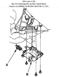

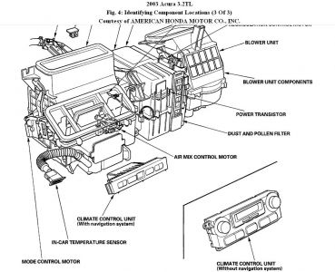

Thank You for the reply . First time I am trying to repair the car. Would like to learn. Sorry for asking basic questions.
1. WHere are the connectors?
2. How do I check the Continuity?
Sep 27, 2010 at 9:25 PM
KHLOW2008
  • 41,814 POSTS
To test for continuity, you would need an ohmmeter to probe the two ends of a wire that you are checking. The connectors are at the air mix motor and climate control panel.
