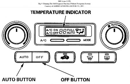

Hi david058, I would suggest doing a self diagnostic to check for trouble codes first. Is your vehicle equipped with navigation system?, the self diagnostic is inbuilt in the control panel and here are the procedures. Let me know what you find.
https://images.2carpros.com/forum/automotive_pictures/192750_HVACSelfDiagnostic03TLFig09_1.jpg

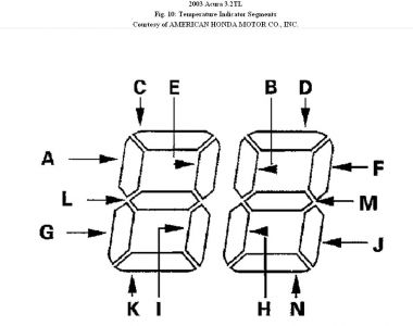

HOW TO RETRIEVE A DTC 1.Turn the ignition switch ON (II). 2.Press the AUTO button and then the OFF button. Continue to hold both buttons down for 1 minute. If there is any abnormality in the system, the temperature indicator will light up the segment (A through N) corresponding to the error. The temperature indicator will then alternate every second between displaying "88" (all segments lit) and the error code segment (A through N). NOTE: The system will only display the DTC when the AUTO and OFF buttons are pressed. If you release the buttons, the display will go blank. To return the display, simply press the AUTO then the OFF buttons again. If there is no abnormality, the segments will not light up.
https://images.2carpros.com/forum/automotive_pictures/192750_HVACSelfDiagnostic03TLFig10_1.jpg
Resetting the Self-diagnosis Function Turn the ignition switch OFF to cancel the self-diagnosis function. After completing repair work, run the self-diagnosis function again to make sure that there are no other malfunctions.
Apr 26, 2021 at 3:57 AM
DAVID058
  • 5 POSTS
thank you for the info on how to diagnose the ac myself. i followed the instructions and display started to blink back and forth between 88 and what appears to be letter I on the diagram. what is this and what to do to fix? i am very good at working on cars and with my hands, just need a little direction and help.thanks, david

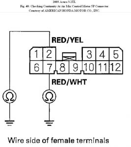

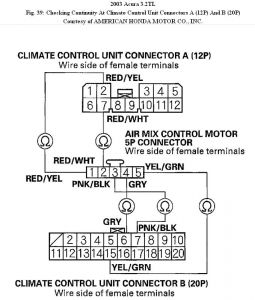

With the skill that you have, this should be a breeze. DTC INDICATOR LIGHT I: AN OPEN IN THE AIR MIX CONTROL MOTOR CIRCUIT 1.Disconnect the air mix control motor 5P connector. 2.Disconnect climate control unit connectors A (12P) and B (20P). 3.Check for continuity between following terminals of climate control unit connectors A (12P) and B (20P) and the air mix control motor 5P connector.
https://images.2carpros.com/forum/automotive_pictures/192750_HVACSelfDiagnostic03TLFig39_1.jpg
https://images.2carpros.com/forum/automotive_pictures/192750_HVACSelfDiagnostic03TLFig40_1.jpg
Is there continuity? YES -Check for loose wires or poor connections at climate control unit connectors A (12P) and B (20P) and at the air mix control motor 5P connector. If the connections are good, substitute a known-good climate control unit, and recheck. If the symptom/indication goes away, replace the original climate control unit. NO -Repair any open in the wire(s) between the climate control unit and the air mix control motor.

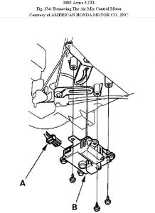

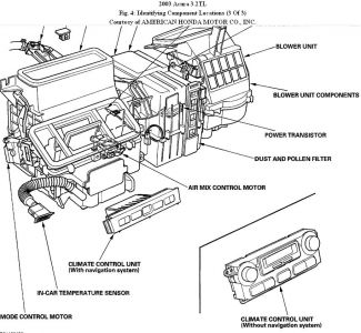

thank you so much for responding..... i will check it with my multi-meter today. i have read that this is a common problen with the mix motors on these cars. i know that i will be pulling the ac control panel out but where is the air mix control moter located if i need to swap it out? between the mix motor and the control panel it sounds like i hope its the mix motor part because it should be cheaper.. any advise would be appreciated
KHLOW2008
  • 41,814 POSTS
These diagrams should be able to assist you.
https://images.2carpros.com/forum/automotive_pictures/192750_AirMixMotor03TLFig044_1.jpg
https://images.2carpros.com/forum/automotive_pictures/192750_AirMixMotor03TLFig134_1.jpg

sorry so long to respond but first chance i got to look. please correct me if im wrong and advise me what to do next. i hope you can help. metered continuity by puting 1 lead on each of the 5 pins and the other on another wire in the other connectors... this is what i got... if wrong please help
5 pin harness
#1 to 2 on 12 pin..... tone
#2 to 7 on 12 pin.... tone
#3 to 7 on 20 pin..... nothing
#4 to 6 on 20 pin ..... nothing
#5 to 15 on 20 pin..... nothing
#2 on 12 pin to ground..... tone
#7 on 12 pin to ground.....tone
whats next please.... thanks
KHLOW2008
  • 41,814 POSTS
Above indiates there is an open between the climate control and the air mix motor.
You need to check if any of the wires have bad connections or is broken somewhere.
