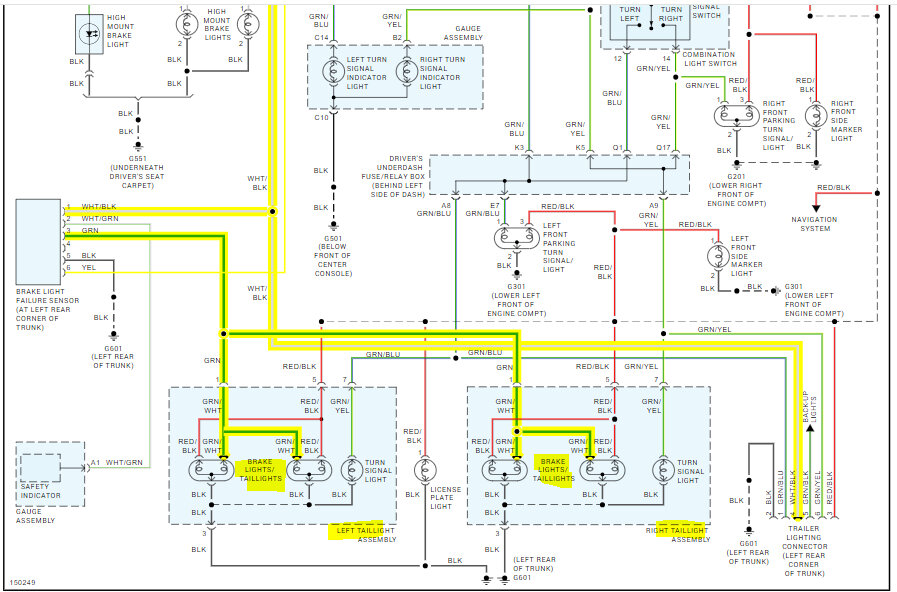

my two brake lights do not work. the upper light in the rear window works. i have replaced the bulbs twice and checked the fuses. still both brake lights do not work, only the one in the rear window does. any iodeas?
Feb 19, 2010 at 4:51 AM
  • 110,194 POSTS

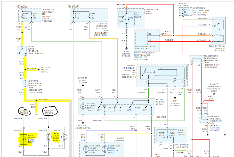

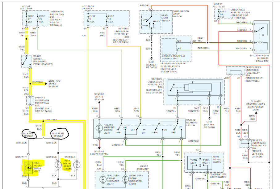

Looking at the wiring schematic, both the left and right brake lights and the center high mount stop lamp (CHMSL) get power from the same supply. So, we need to do some checking.
I attached the wiring schematic below so that you would have a reference. I need you to locate the green wire with the white tracer. There will be one on both sides at the lamp assembly. I need you to check if there is a power present. You can use a simple test lamp for this. Just have a helper press the brake pedal when you check.
Let me know what you find. Also, let me know if there is an indicator showing a bulb is out.
See pics below. Note: I cut the schematic in half to make it readable for you. I did overlap the two so you can follow from one to the next and highlight the relevant wiring.
