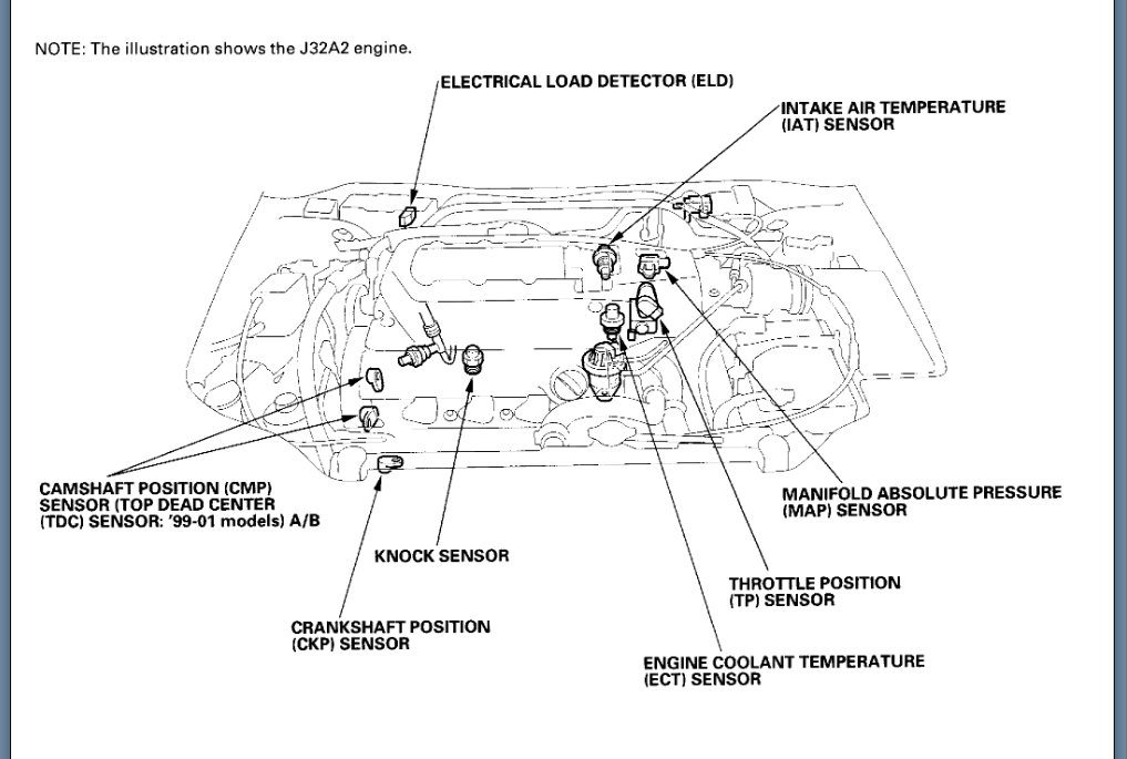

Where is the crankshaft position sensor located?

Crankshaft position sensor location.

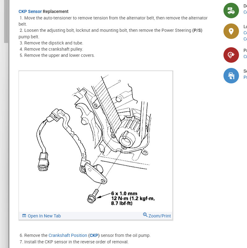

No problem. I will attach the info below from the manual. However, here are a couple guides that will help with this:
Please see the info below and let us know if you have other questions on this.
