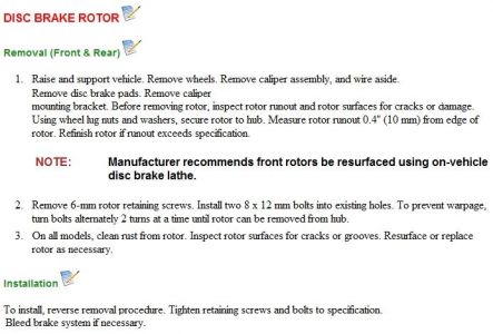

The only part left to remove is the brake rotor. What do I do next?

You need a hammer and a tool called an impact driver with a #3 phillips bit to remove the 2 screws
