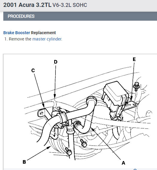

Problem with brakes hissing from under the dash: After replacing rotors, brake disc pads, calipers and bleeding the brake system. The brakes work great for the first 8,000 miles the they start to hiss I need a new booster please.
May 16, 2010 at 12:02 PM
DANNY L
  • 5,648 POSTS
Hello, I'm Danny.

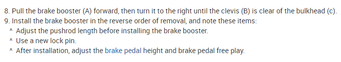

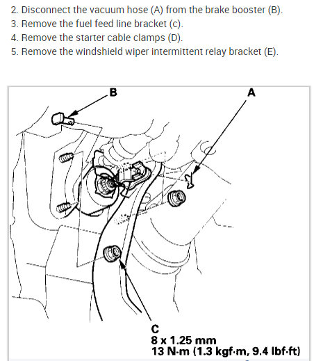

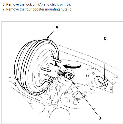

Here is the information you requested. Be sure to just move the brake master cylinder slightly out of the way so that you don't have to open a line and then have to bleed the brake system. I've attached picture steps below on how to change the power brake booster on your car. Hope this helps and thanks for using 2CarPros.
