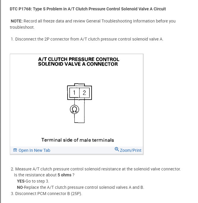

Diagnostic test showed this code p1768 manufacture control transmission. What does this mean? I've had so many problems with my trans I've spent over 5000$ and its still no good. Please help me.
Thursday, December 11th, 2008 AT 8:07 PM

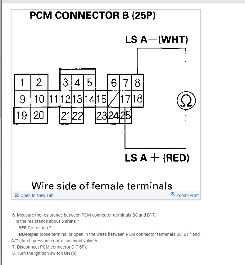

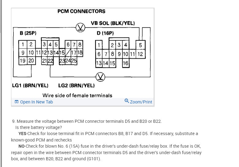

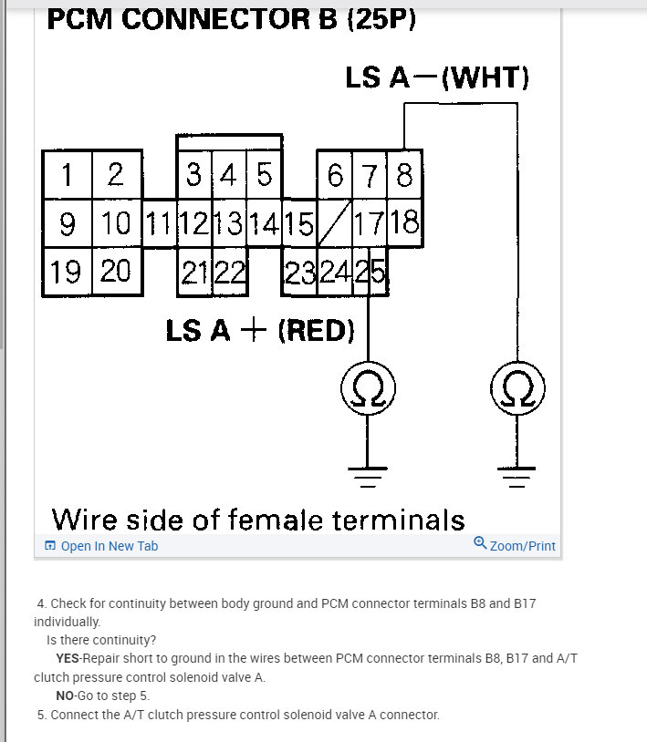

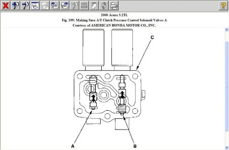

This code tells you that you have a circuit issue with the clutch pressure control solenoid valve A.
Basically, this could be a connector, circuit, or control module issue.
So, we need to run through the testing that I will attach below.
Here is a guide that will help with checking the voltage on these circuits:
Please see the testing below and let us know what you find on this.
