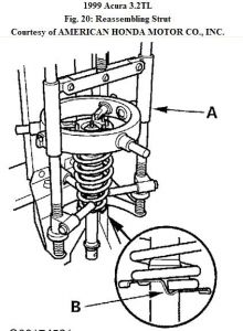

How do I change the stuts on my 99 TL?

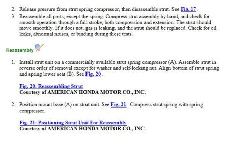

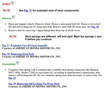

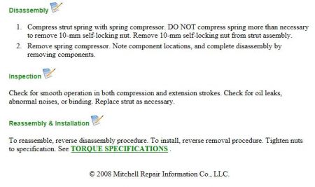

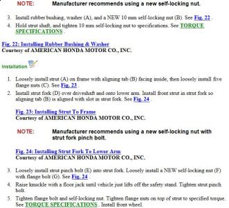

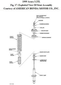

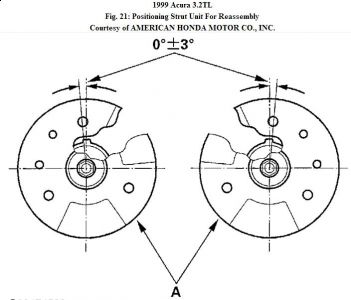

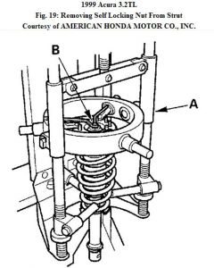

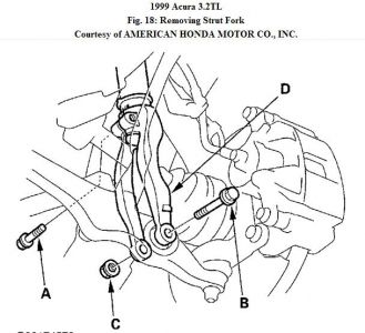

Hi, Just curious, how many accounts do you have here? ;) Here are the procedures for front struts.
https://images.2carpros.com/forum/automotive_pictures/192750_StrutFrt99AcuraTL01_1.jpg
https://images.2carpros.com/forum/automotive_pictures/192750_StrutFrt99AcuraTL02_1.jpg
https://images.2carpros.com/forum/automotive_pictures/192750_StrutFrt99AcuraTL03_1.jpg
https://images.2carpros.com/forum/automotive_pictures/192750_StrutFrt99AcuraTL17_1.jpg
https://images.2carpros.com/forum/automotive_pictures/192750_StrutFrt99AcuraTL18_1.jpg
https://images.2carpros.com/forum/automotive_pictures/192750_StrutFrt99AcuraTL19_1.jpg
https://images.2carpros.com/forum/automotive_pictures/192750_StrutFrt99AcuraTL20_1.jpg
https://images.2carpros.com/forum/automotive_pictures/192750_StrutFrt99AcuraTL21_1.jpg

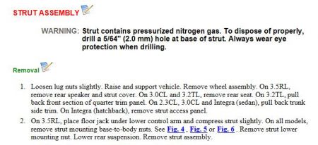

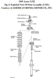

Rear strut
https://images.2carpros.com/forum/automotive_pictures/192750_StrutRrAcuraTL01_1.jpg
https://images.2carpros.com/forum/automotive_pictures/192750_StrutRrAcuraTL02_1.jpg
https://images.2carpros.com/forum/automotive_pictures/192750_StrutRrAcuraTL06_1.jpg
