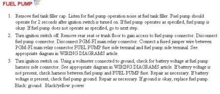

how do you know if your fuel pump in not working right

https://images.2carpros.com/forum/automotive_pictures/55316_99tlfuelpump_1.jpg
