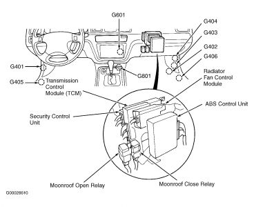

I bought and installed a new relay switch but that did not solve the problem...the fan continues to run even after the car is off until the battery is dead. any ideas? The radiator and thermostat has been replaced recently...the problem began before that and continues. Thanks

check or replace radiator fan control module on right side of instrument panel
https://images.2carpros.com/forum/automotive_pictures/266999_fan_1.jpg
