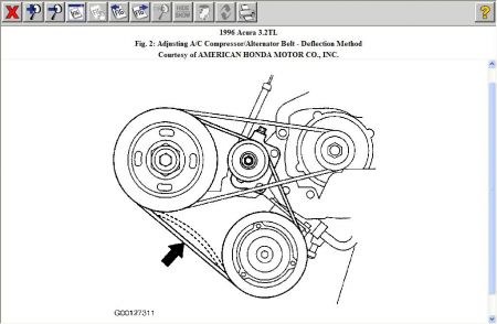

Can you tell me what part(s) and services I need If my belt jumps on and off of the altinator and I cant start my car without getting a jump?

Hi Sh3m3tris, Thank you for the donation. If the alternator belt keeps jumpng off, it could be due to : 1. Faulty alternator pulley or alternator bearing. 2. Faulty crank pulley. 3. Improperly adjusted alternator belt. Check which is causing the problem. This would cause the alternator not to charge and requires jump starting. You might need to replace any one or more of the above and also the alternator needs to be tested for charging rate.
https://images.2carpros.com/forum/automotive_pictures/192750_DriveBelt96AcuraTL32_1.jpg
