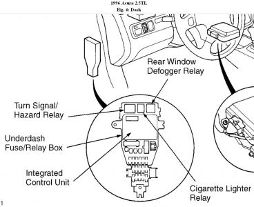

blinkers in front dont flash
got a flasher fuse and cannot find where to install it
not in either fuse boxes
Tuesday, September 28th, 2010 AT 3:53 PM
KHLOW2008
MECHANIC
41,814 POSTS
Hi trinamoseng,
Do you mean you are looking for the flasher relay?
It is in underdash fuse box.
