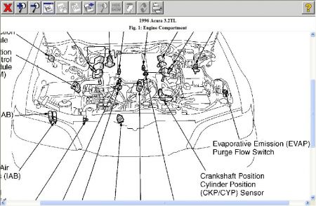

1996 Acura TL 6 cyl Automatic 185000 miles
what do you have to do to replace the crankshaft sensor and about how much money does it cost

Hi ebonyt,
Labor time is 3.1 hours.
Part cost $ 199.
Item is located at frot of left cylinder head, behind timing belt cover. Replacement involves removal of camshaft sprocket and timing belt.
