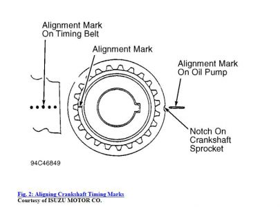

I want to install a new timing chain (belt?) and could use some coaching. Suggestions?

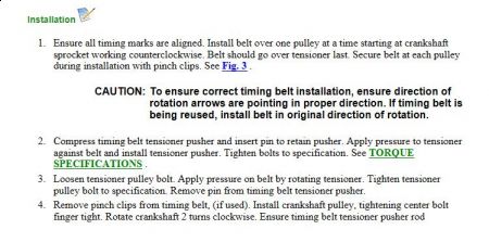

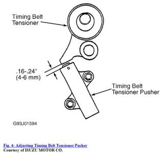

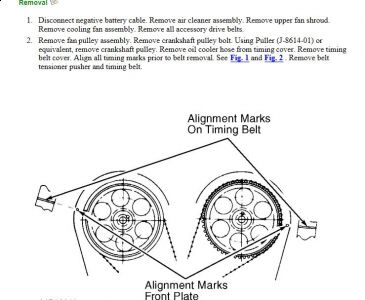

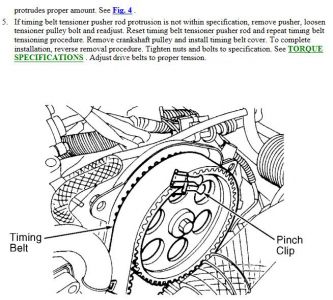

Hi aerospares, Hope this is helpful.
https://images.2carpros.com/forum/automotive_pictures/192750_TimingBelt97AcuraSLX01_1.jpg
https://images.2carpros.com/forum/automotive_pictures/192750_TimingBelt97AcuraSLX02_1.jpg
https://images.2carpros.com/forum/automotive_pictures/192750_TimingBelt97AcuraSLX03_1.jpg
https://images.2carpros.com/forum/automotive_pictures/192750_TimingBelt97AcuraSLX04_1.jpg
https://images.2carpros.com/forum/automotive_pictures/192750_TimingBelt97AcuraSLX05_1.jpg
