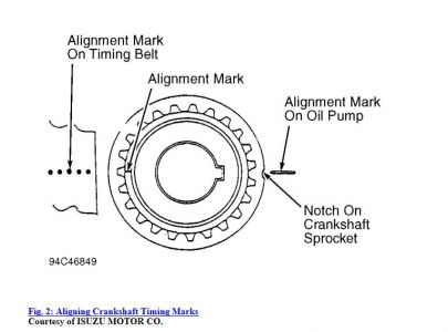

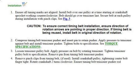

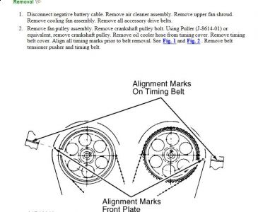

I want to install a new timing chain (belt?) and could use some coaching. Suggestions?
gr
Mar 5, 2009 at 12:19 AM
KHLOW2008
  • 41,812 POSTS
Hi aerospares, Hope this is helpful.
