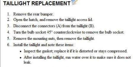

2004 Acura RSX remove and replace rear light assembly
2004 ACURA RSX
70,000 MILES • 4 CYL • 2WD • AUTOMATIC
FZWIBEL
MEMBER
1 POST
broken rear light assembly
Jun 9, 2010 at 5:52 AM
BLUELIGHTNIN6
Experienced Mechanic
16,542 POSTS
Jun 9, 2010 at 4:36 PM
