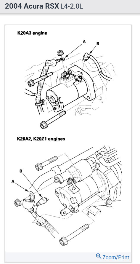

Brand new battery. When I turn on car panel lights light up, no click sound. In the beginning it would turn on after second or third attempt but now it will not start. I can push start the car and runs fine but once I turn it off will not turn on again.
Oct 31, 2010 at 1:27 AM
KHLOW2008
  • 41,814 POSTS

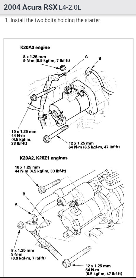

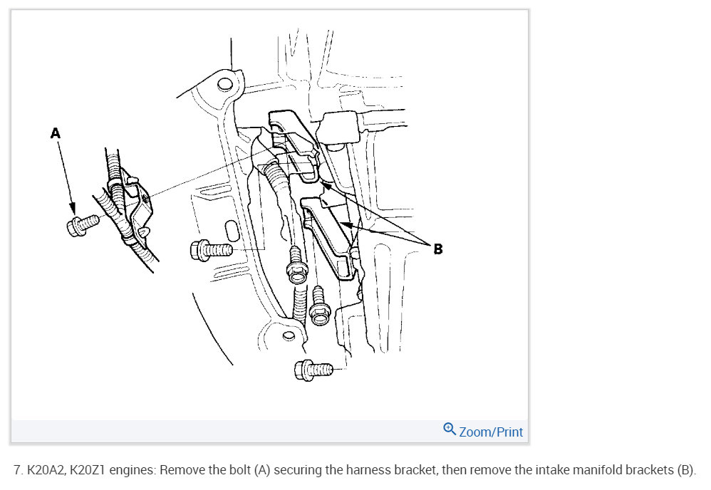

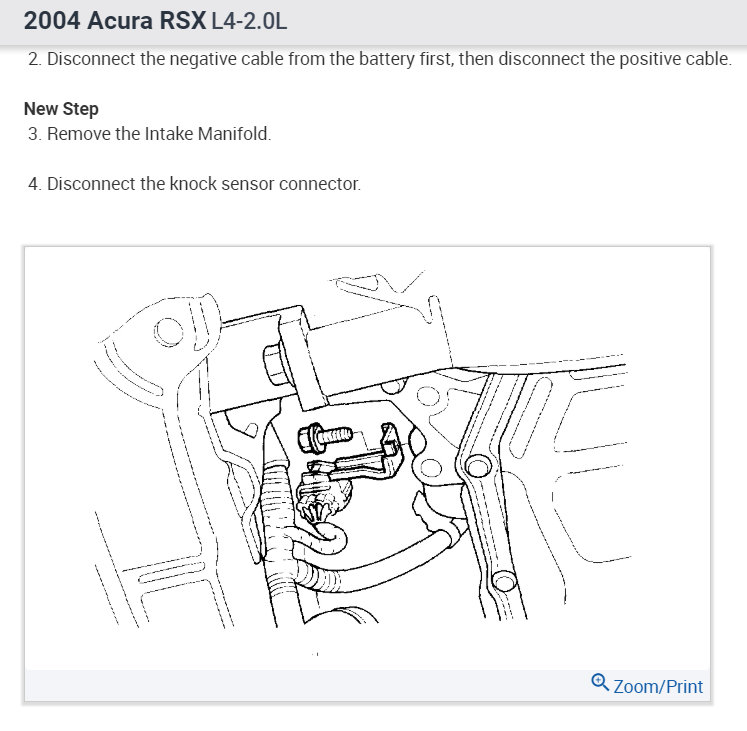

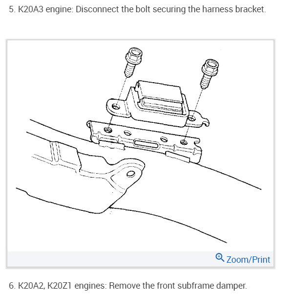

This sounds like you have a bad starter but to confirm the issue use a test light to see if the small trigger wire is getting power when the key is turned if so the starter is bad. Here are two guides to help you see whats going on and how to change out the starter with diagrams below:
and
Cheers
