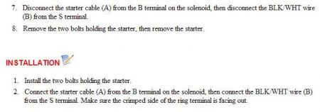

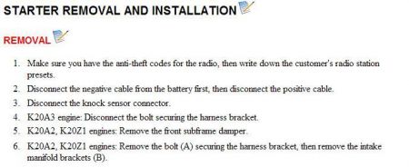

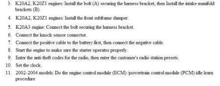

How do you replace starter on Acura RSX 2003
Saturday, February 27th, 2010 AT 6:27 PM
BLUELIGHTNIN6
MECHANIC
16,542 POSTS
SPONSORED LINKS
-1
Saturday, February 27th, 2010 AT 10:08 PM
