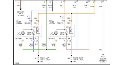

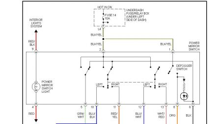

I'm currently trying to update my car, and I curious as to what the wiring of the side view mirrors work. I'm trying to convert the wiring of these new spoon mirrors for my RSX into the stock wiring. I have tried to look everywhere to see what can be done, but most of the people who have installed the mirrors have just glued them on, and I think that is personally tacky and I would love to learn the wiring concepts of the side mirrors. Thank you!

Hi sphanth, Is this what you are looking for?
https://images.2carpros.com/forum/automotive_pictures/192750_PowerMirror03RSX01_1.jpg
https://images.2carpros.com/forum/automotive_pictures/192750_PowerMirror03RSX02_1.jpg
