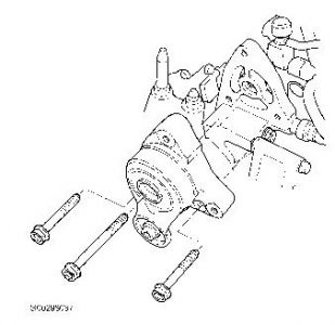

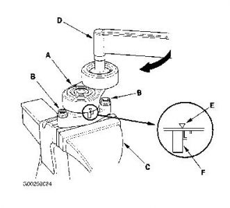

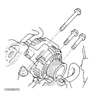

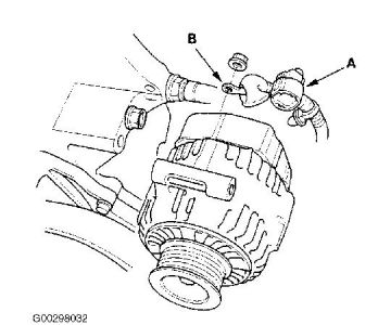

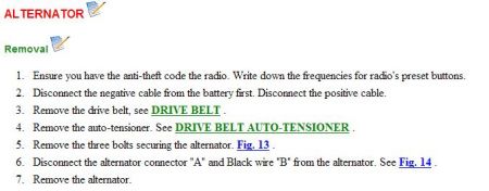

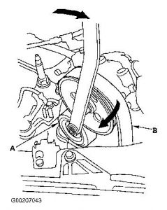

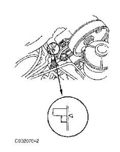

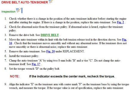

how do i replace an altenator in this car?
Jan 20, 2009 at 3:45 PM
BLUELIGHTNIN6
  • 16,542 POSTS
Hello Thanks for the donation. Alternator removal/installation procedures are below.
https://images.2carpros.com/forum/automotive_pictures/261618_Noname_9.jpg
https://images.2carpros.com/forum/automotive_pictures/261618_Noname2_11.jpg
https://images.2carpros.com/forum/automotive_pictures/261618_Noname3_5.jpg
INSTALLATION OF ALTERNATOR
https://images.2carpros.com/forum/automotive_pictures/261618_Noname4_3.jpg
FIGURE 13
https://images.2carpros.com/forum/automotive_pictures/261618_fig13_1.jpg
FIGURE 14
https://images.2carpros.com/forum/automotive_pictures/261618_fig14_1.jpg
FIGURE 15
https://images.2carpros.com/forum/automotive_pictures/261618_fig15_1.jpg
FIGURE 2
https://images.2carpros.com/forum/automotive_pictures/261618_fig2_5.jpg
FIGURE 16
https://images.2carpros.com/forum/automotive_pictures/261618_fig16_1.jpg
FIGURE 20
https://images.2carpros.com/forum/automotive_pictures/261618_fig20_1.jpg
FIGURE 17
https://images.2carpros.com/forum/automotive_pictures/261618_fig17_2.jpg
