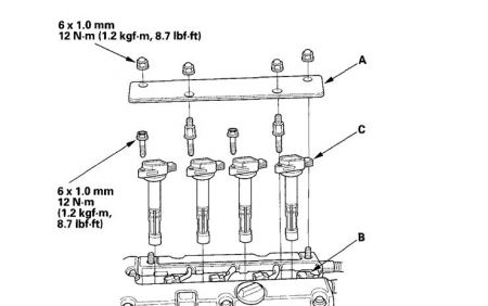

How do i replace the engine air intake filter, and how do i change the spark plugs

Spark plugs: Remove the coil cover and coils to access them.
https://images.2carpros.com/forum/automotive_pictures/276698_RSX_coil_1.jpg
Air filter: locate the air box, there will be roughly 6 8mm screws you have to loosen to access the filter
