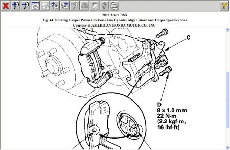

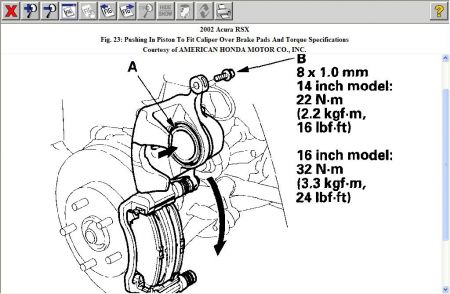

What is the required torque for front and rear caliper mount bolts?
Also, where do I apply the grease that is supplied with the OEM break pads?
Thanks
