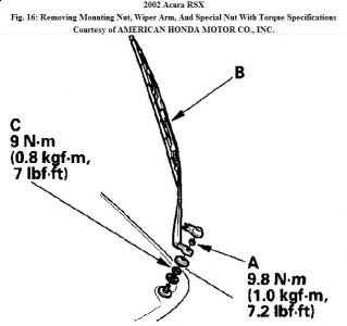

The rear window wiper has gone loose hence inoperative. I'm trying to gain access without succes but have no clue where to start.

Hi Marz, Pry out the cap for tightening the nut (A) and check if the nut is loose. Readjust the wiper arm position before tightening if it is loose.
