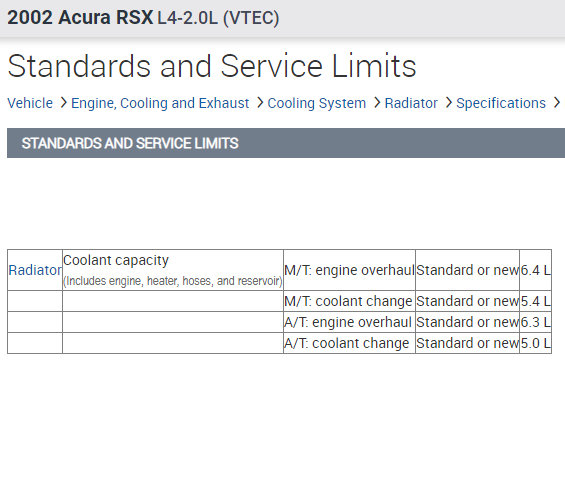

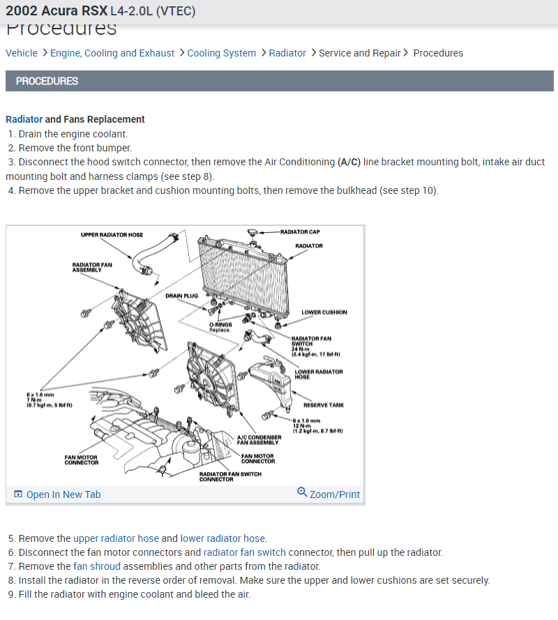

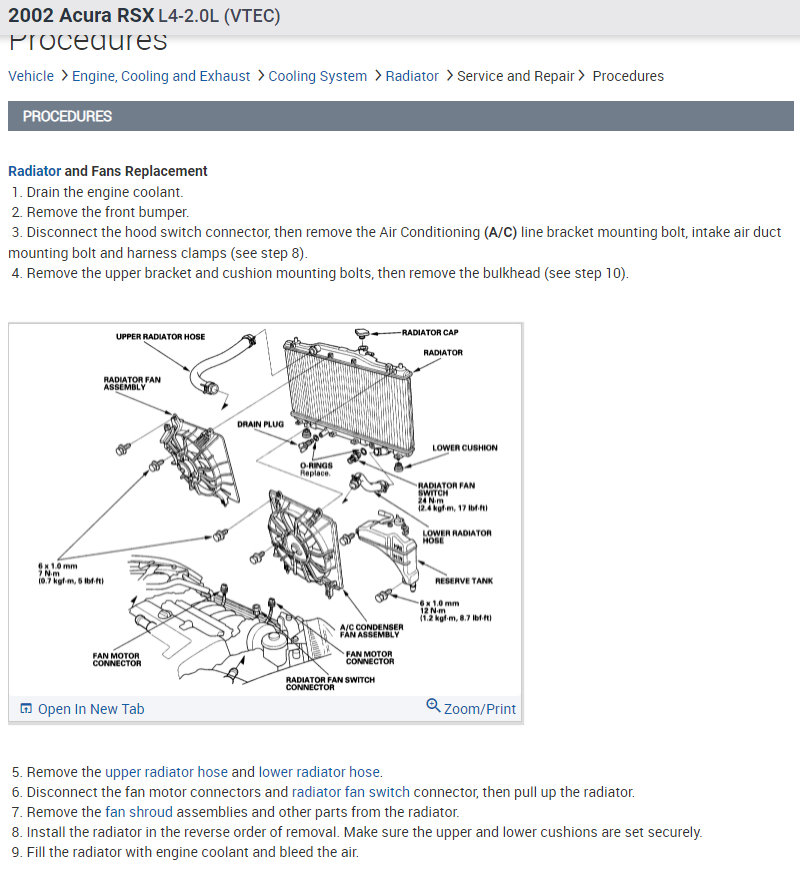

Coolant Radiator light on the dashboard just light up, do I need to add fluid to the reserve coolant tank or do I have to open up the radiator cap. Will a new radiator stop the leak if so can you show me how to change it out?

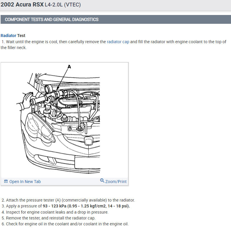

First you will have determine where is the leak coming from. If it is from the radiator, then changing the radiator will likely fix the problem.
Please note that many times the leaks are from one of the radiator hoses or bypass hoses.

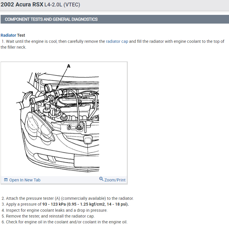

You can also pressure test the radiator for any leaks. There is a easy to use tool that adds pressure to the radiator system to see if there is any leak. This tool can be borrowed from just about any parts store.

Here is a helpful guide of how to change the radiator:
https://www.2carpros.com/articles/how-to-replace-a-car-radiator
I have also attached the radiator replacement procedure as well as capacity of coolant for your RSX.
