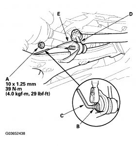

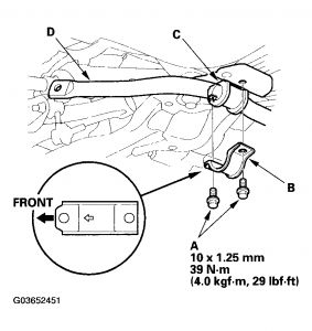

My front right stabilizer is bent and i have a new one. what are the steps to uninstall the old broken one and install the new one? Thank you.

Hi HallsGTR, You need to remove the stabilizer link first.
https://images.2carpros.com/forum/automotive_pictures/192750_AcuraRSX02StabilizerLink_1.jpg
https://images.2carpros.com/forum/automotive_pictures/192750_AcuraRSX02StabilizerLink01_1.jpg
