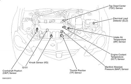

Hi Maybe faulty Engine Coolant Temp sensor located rear cylinder head
https://images.2carpros.com/forum/automotive_pictures/198357_Graphic_438.jpg
Ohm check sensor high resistence lowers as engine warms. Let me know Thanks for donate
