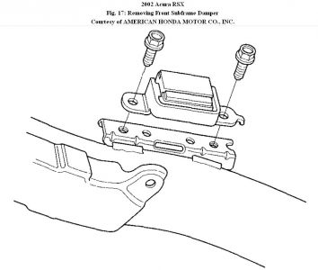

does anyone have detailed info on switching out a starter on a 2002 acura rsx v-tech 2.0 engine??? PLEASE HELP

5. K20A2, K20Z1 engines: Remove the front subframe damper.
https://images.2carpros.com/forum/automotive_pictures/192750_StarterRemoval02RSXFig17_1.jpg
