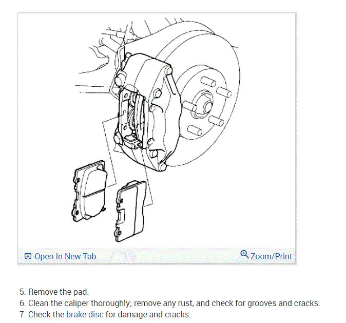

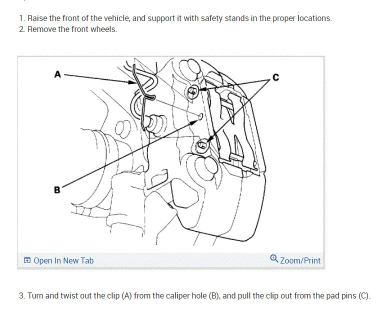

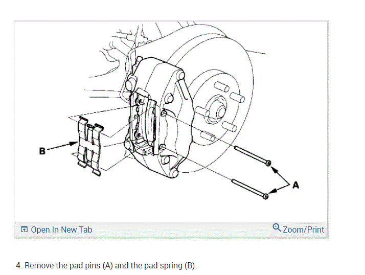

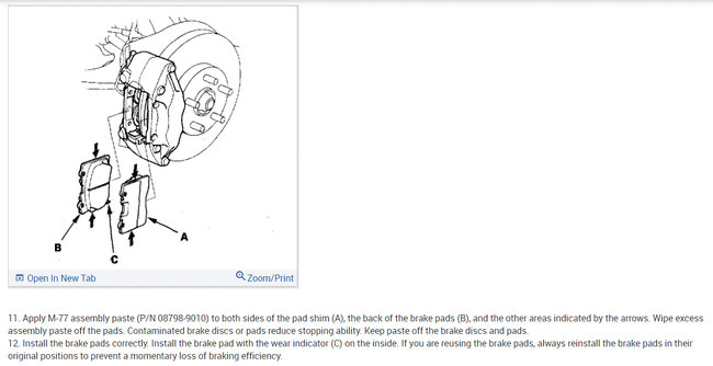

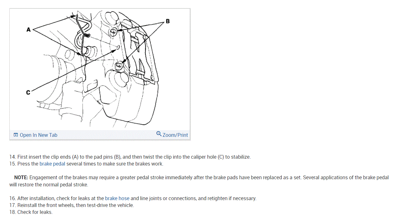

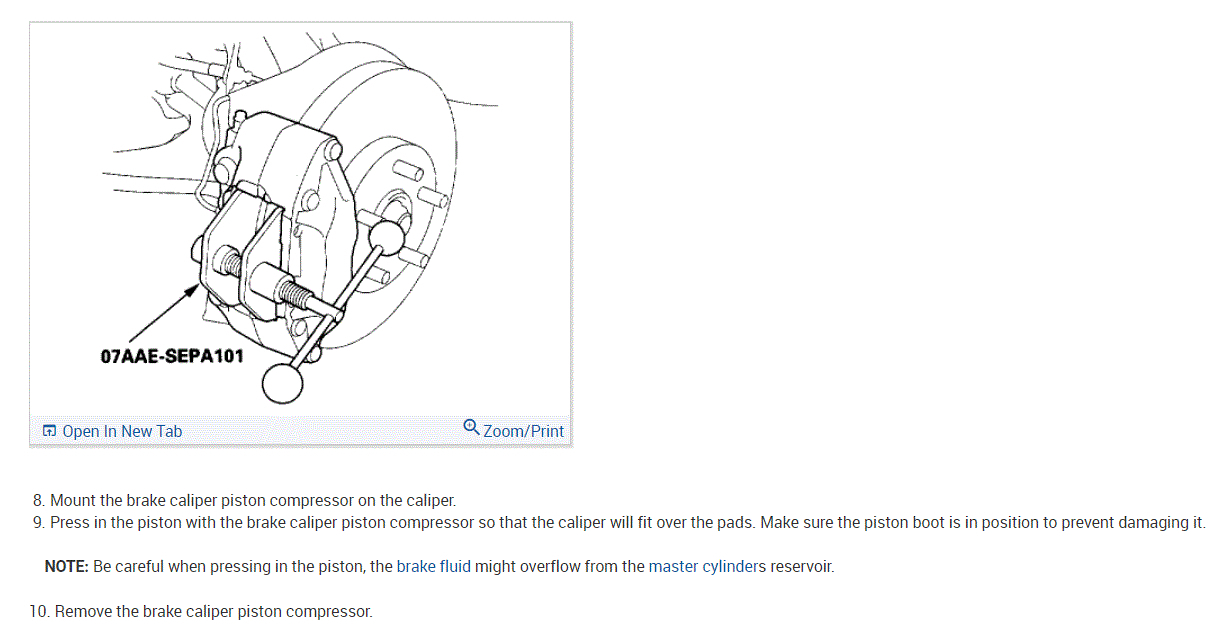

How do i do my own brake to help me save money?
Apr 7, 2009 at 2:02 AM
  • 110,248 POSTS

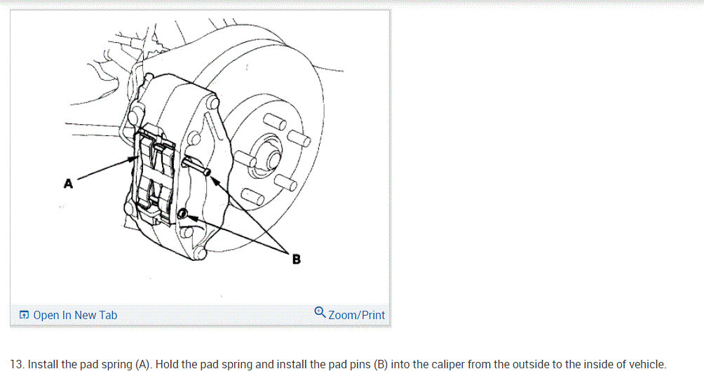

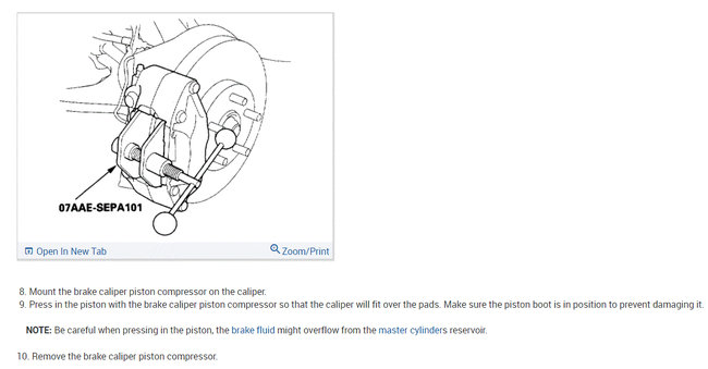

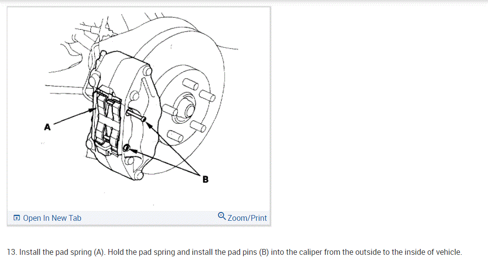

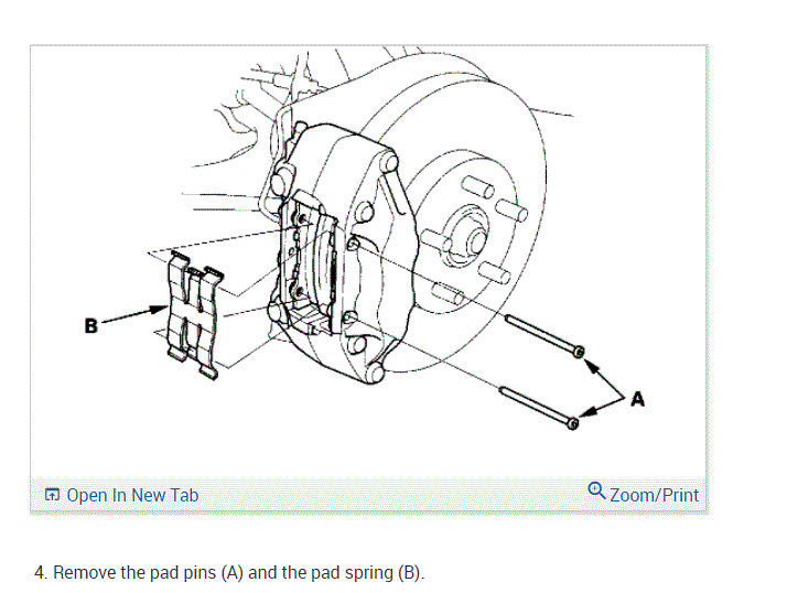

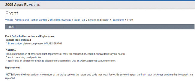

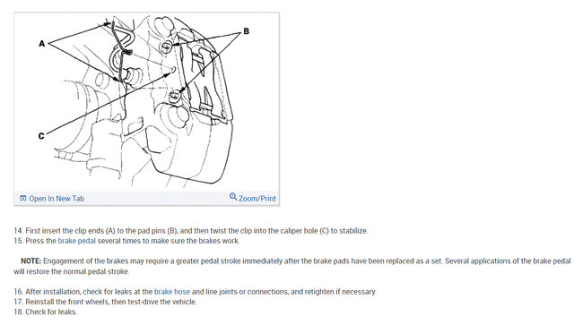

Replacing front brakes and rotors really isn't too hard. Under normal conditions, you can expect them to last approximately 25,000 miles. However, that can change based on driving habits and terrain.
To get you started, here is a link that shows in general how it is done. You can use this to help guide you in the process.
If you look at the attachments below, they include the directions and pics specific to your vehicle for replacement.
Also, here is a video showing the procedure being done on an Acura TL.. Although it is a different model, the procedure is very similar.
https://youtu.be/gMGpzJKb7uI
One you have the caliper removed, you will also need to remove the caliper mount as ween in the video. Remove the two retaining bolts on the rear of the spindle, remove the mount, and then remove and replace the brake rotor.
I hope this helps you. Let me know if you have other questions.
