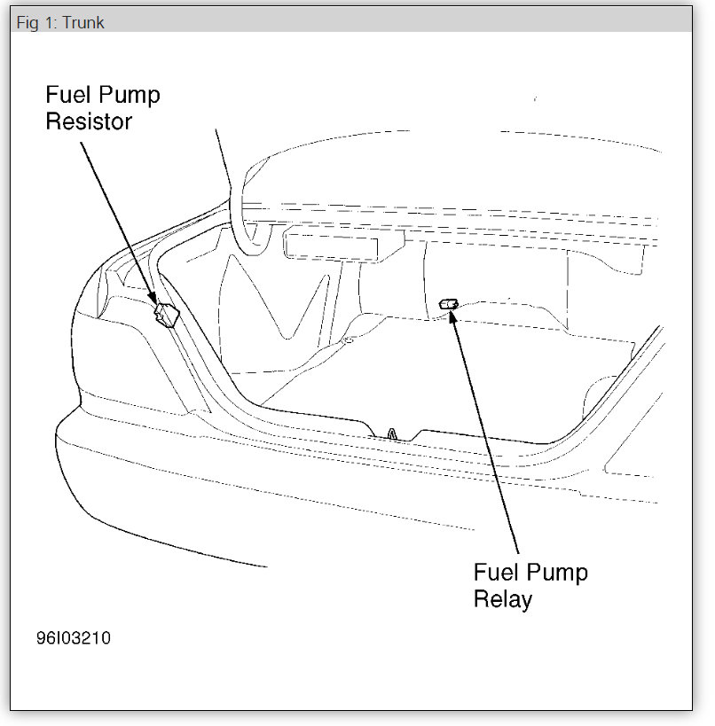

Where is the fuel pump relay (main relay) located? Is it on or near the steering column?
Saturday, October 3rd, 2009 AT 10:19 AM
MECHANIC
75,992 POSTS
The fuel pump relay is in the front side of the trunk. Here is a guide to help test it and the location below.
