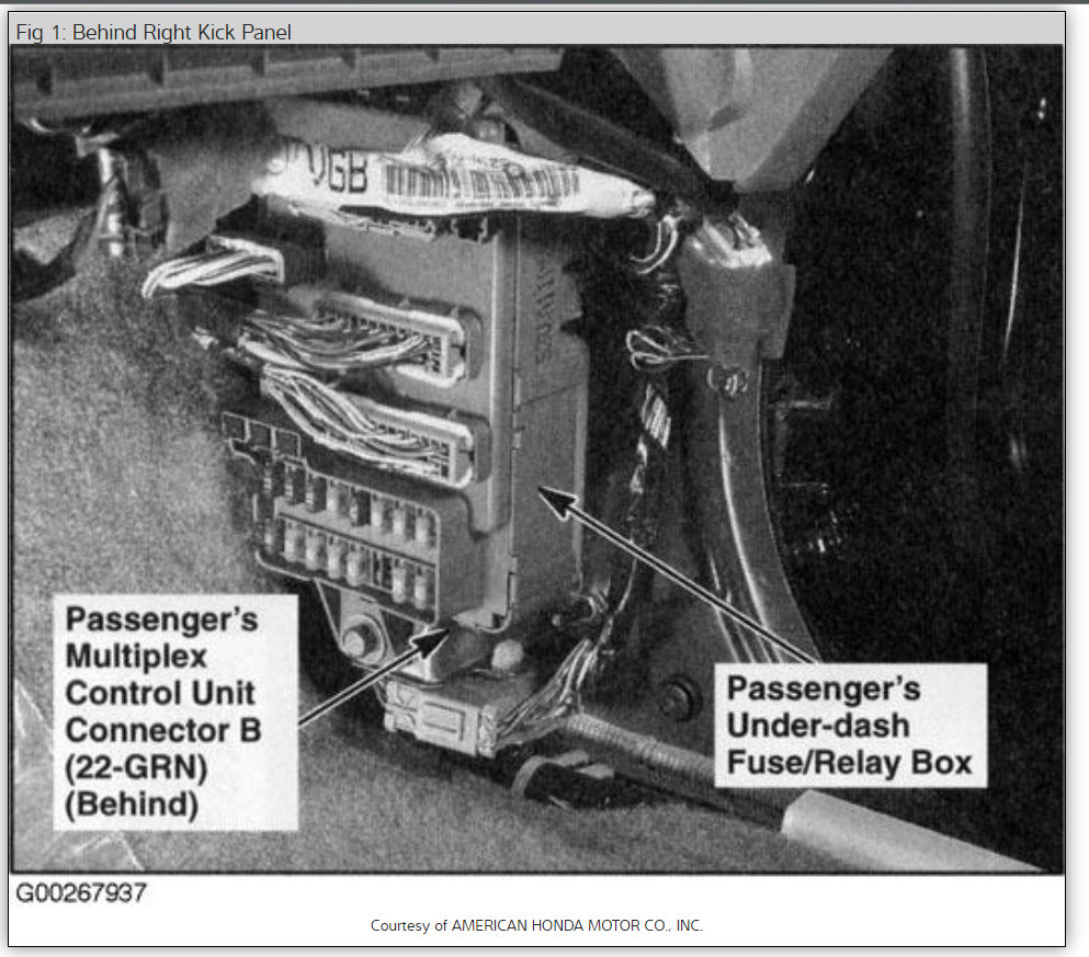

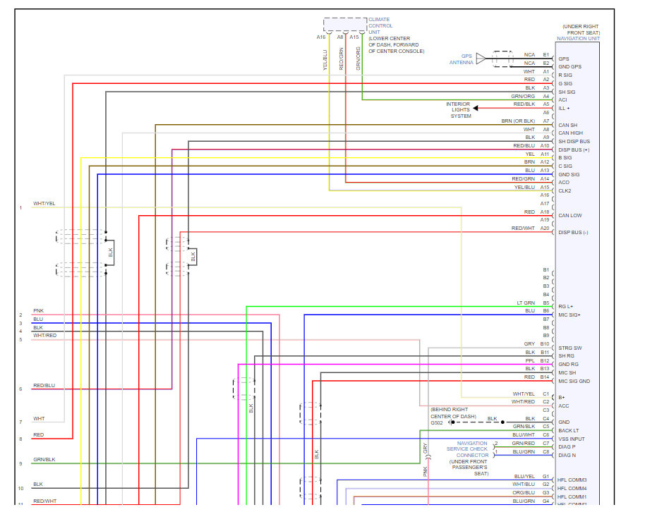

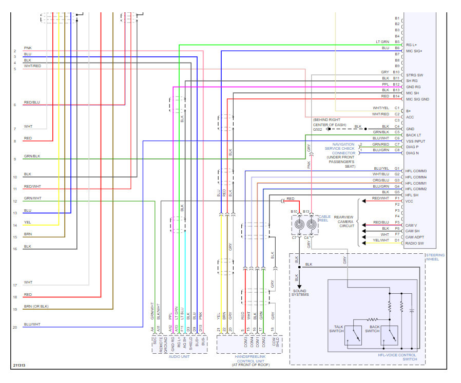

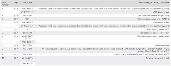

I left my headlights on and couldn't start the car. So I jumped it and it started ok. I had to enter the radio code and the rado came back. The GPS which is touch screen did not return and thus a cannot enter the code since the screen does not turn on. Is this a fuse problem or is there a reset for the thing?
Aug 12, 2010 at 8:03 AM
KHLOW2008
  • 41,814 POSTS
Hi william1214,

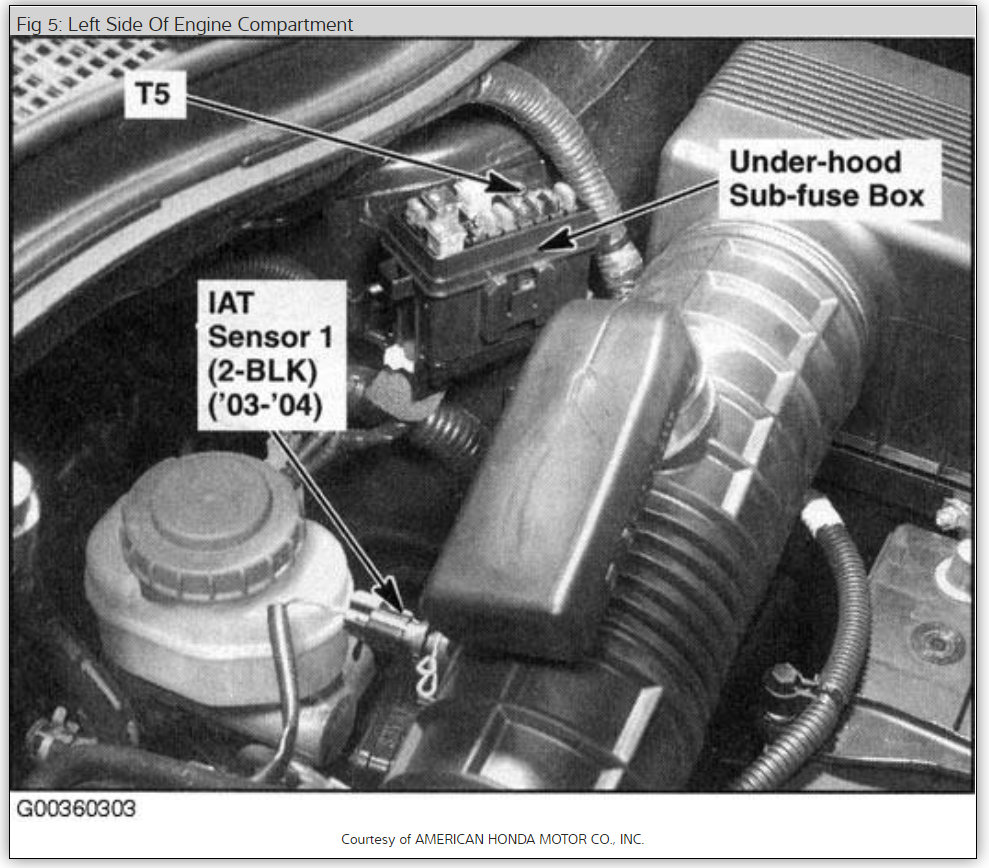

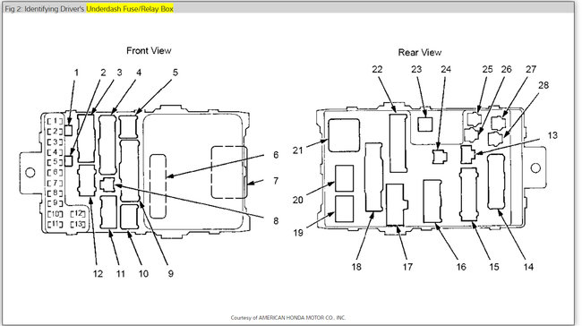

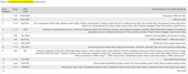

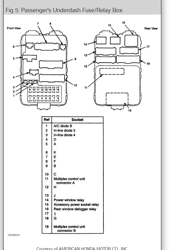

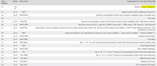

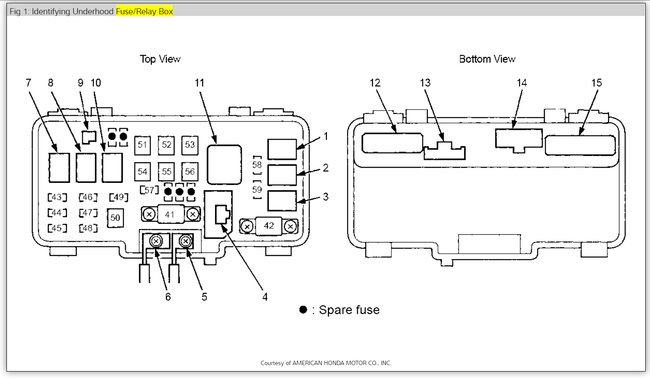

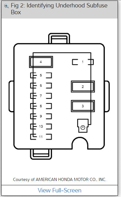

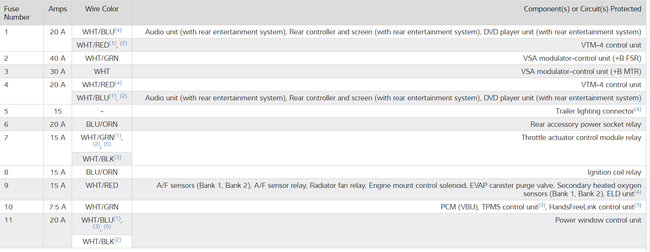

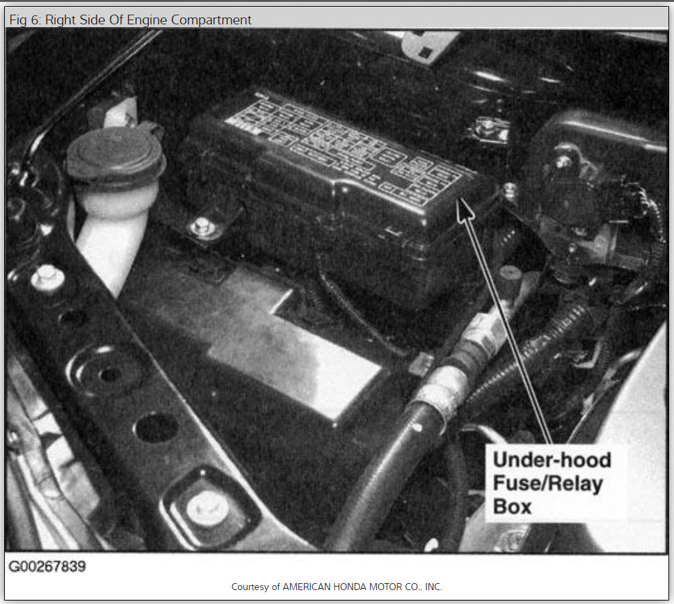

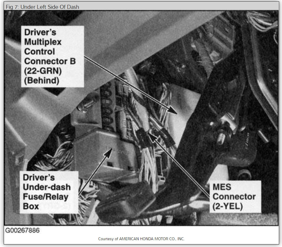

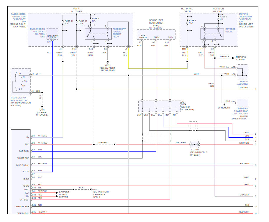

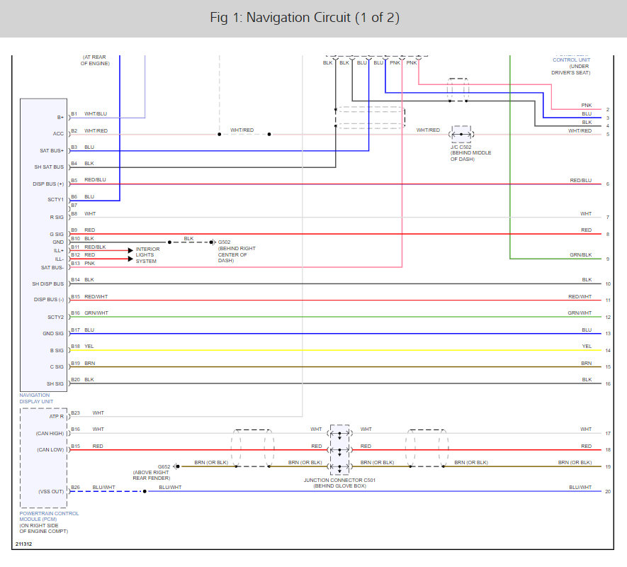

It sounds like it could be a fuse (11, 13, 9 and 8) here is the GPS wiring diagrams so you can see how the system works plus a guide to help check the fuses with the fuse locations in the diagrams below.
Check out the diagrams (Below). Please let us know what you find. We are interested to see what it is.
Aug 13, 2010 at 8:00 AM
ZANYJB
I checked out my car the fuse was bad, it had corrosion in the box, working now. thanks for the info.
