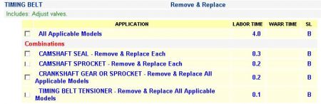

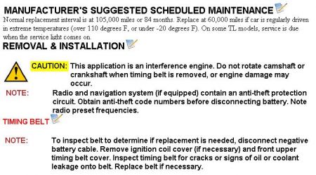

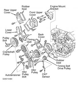

What is recommended replacement schedule? Should the idler and water pump be repalced at the same time? How many shop hours does this job require?

You should replace the idler. Water pump does not run off the timing belt, so no.
