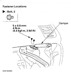

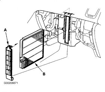

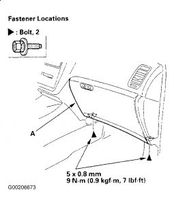

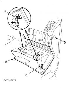

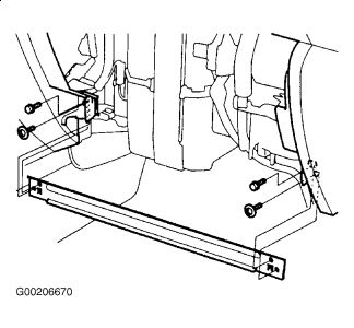

Follow diagrams
https://images.2carpros.com/forum/automotive_pictures/198357_Graphic_249.jpg
https://images.2carpros.com/forum/automotive_pictures/198357_Grafic_3_72.jpg
https://images.2carpros.com/forum/automotive_pictures/198357_Grafic_4_19.jpg
https://images.2carpros.com/forum/automotive_pictures/198357_Graphic_5_9.jpg
https://images.2carpros.com/forum/automotive_pictures/198357_Graphic_6_6.jpg
