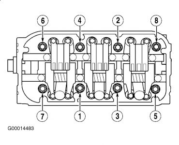

Hello ;
Looking for torque spec's and sequence for head replacement .
Thank You , Clayton
Aug 18, 2009 at 12:19 PM
BMRFIXIT
  • 19,053 POSTS
Cylinder Head Bolt Lbs. (N.m) 1st Step ======29 (39) 2nd Step ===== 51 (69) 3rd Step ===== 72 (98)
https://images.2carpros.com/forum/automotive_pictures/99387_Graphic1_466.jpg
