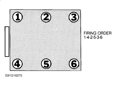

https://images.2carpros.com/forum/automotive_pictures/261618_Graphic_120.jpg

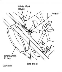

https://images.2carpros.com/forum/automotive_pictures/261618_Graphic2_13.jpg
