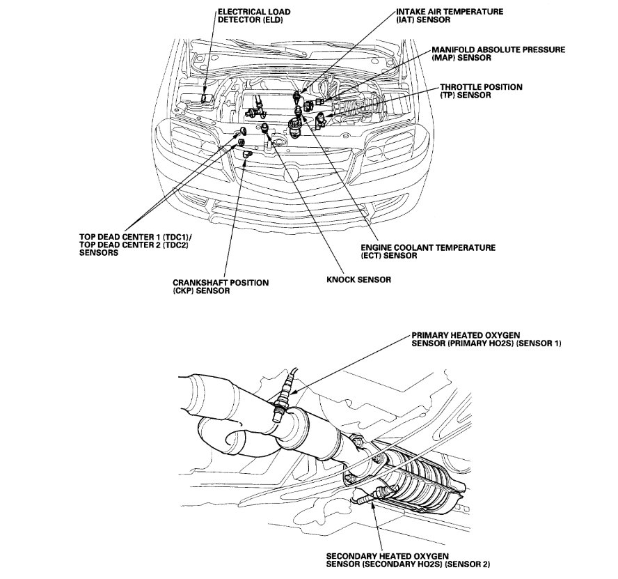

My car get scanned and they found a code PO135 and tell me to replace the oxygen sensor1 in bank 1. I bought the sensor and I want to do it my self. But I don't where is this sensor. I saw a few of this sensor in the motor. And I don't wich one I'm going to replace. If you can help me with a diagram. I can appreciate that. Thank you

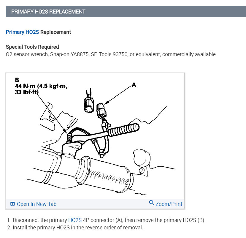

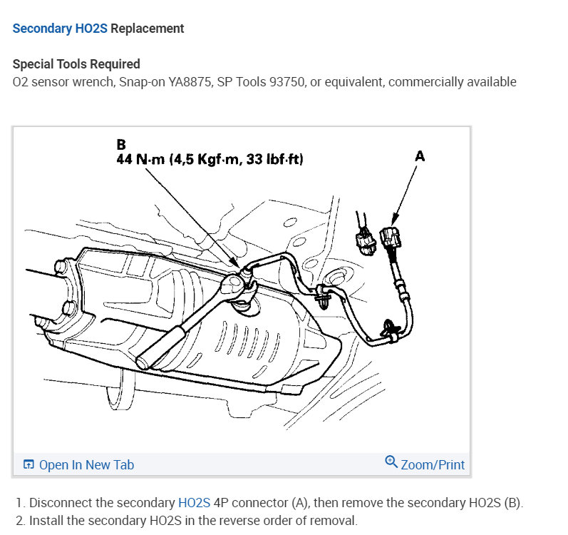

B1S1 is on the exhaust pipe upstream from the catalytic converter. The other is on the C/Converter. Here is a guide t help walk you through the repair and the location of the oxygens sensors in the diagrams below.
https://www.2carpros.com/articles/how-to-replace-an-oxygen-sensor

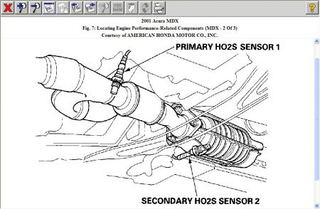

Hi davegoya, It is the primary sensor.
https://images.2carpros.com/forum/automotive_pictures/192750_O2SensorAcuraMDX01_1.jpg
