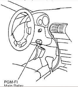

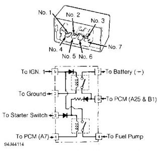

Location of the main relay (fuel pump)
BUBBASIS427
We are trying to find the location of the main relay for the fuel pump on a 1994 LS model, four door sedan, 3.2 Liter V6, 187,204 miles. we have looked on several other sites and in the Chilton import car manual (not specific to model).
Nov 2, 2007 at 12:42 PM
BMRFIXIT
  • 19,053 POSTS
The fuel pump relay on your car is an integral component of the main relay which is located to the left lower side of the steering column.
