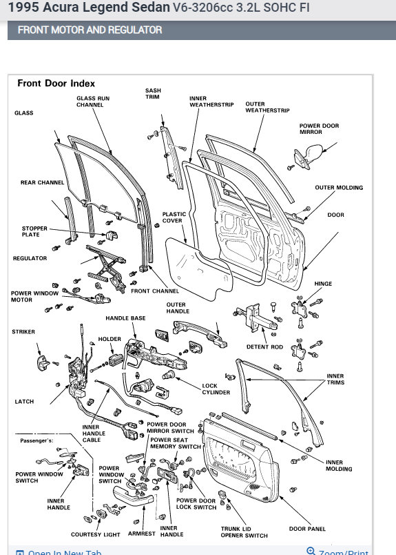

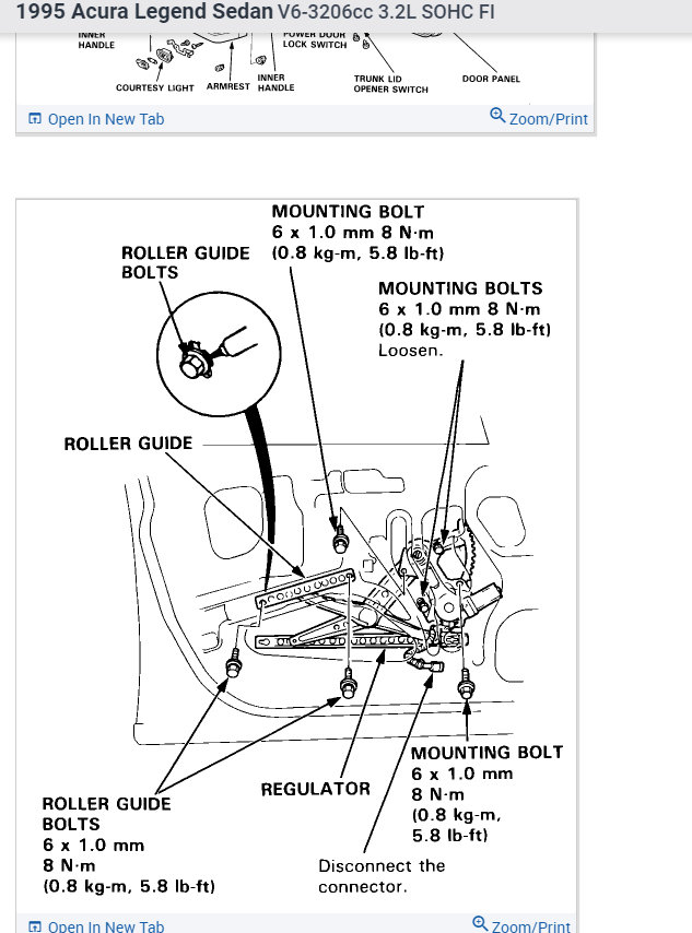

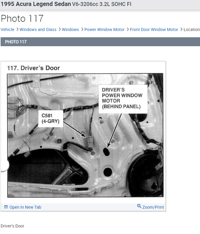

I was going to take a look at the glass on the driver's side front door. I got the inner molding and all loose, except the inside door handle. This inside handle is holding everything from coming off. Please inform me, thanks.

There is a mounting screw for the door handle. After removal of that screw, you will be able to remove the door handle. Pay close attention to the connecting rods for the handle.
Here is a helpful guide:
https://www.2carpros.com/articles/door-panel-removal
I have attached diagrams of the door below for your reference.
